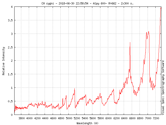

Ok, I have a clear forecast to at Tours.
I'll try CH cygni tonight with Alpy
Clear sky

Thank you Vincent! Alpy's blue end will be an important addition! - Peter

This is the result
CH cygni. Expect this is usefull !
Vincent

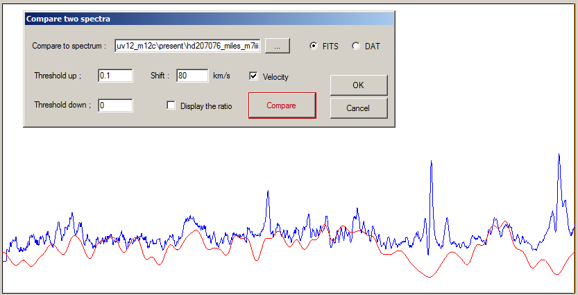

Hello Vincent!
Visually, your spectrum seem to match well with hd207076.

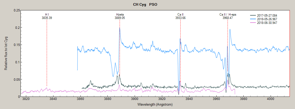

Here is my spec. compared to a miles M7III star (my resolution is R~5500 average - considerably higher than the miles), suspecting a similar event: Unfortunately, I will need to wait for a good sky again (= one of the next weekends unless anyone provide...) to catch an M7III star for substraction and calculate the precise M7III ratio, allowing to extract other features as well.
But, it looks roughly almost the whole Be comp. light has just been lost.

- Posts: 420
Re: CH Cyg session 2018.06.30
Forgot to add, processed all my UV spectra relative to Iot Cyg, and the drop is obvious (with M-ish features on top remained):
So it is showing better what I wanted to point out.
- Peter
