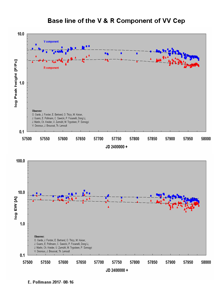

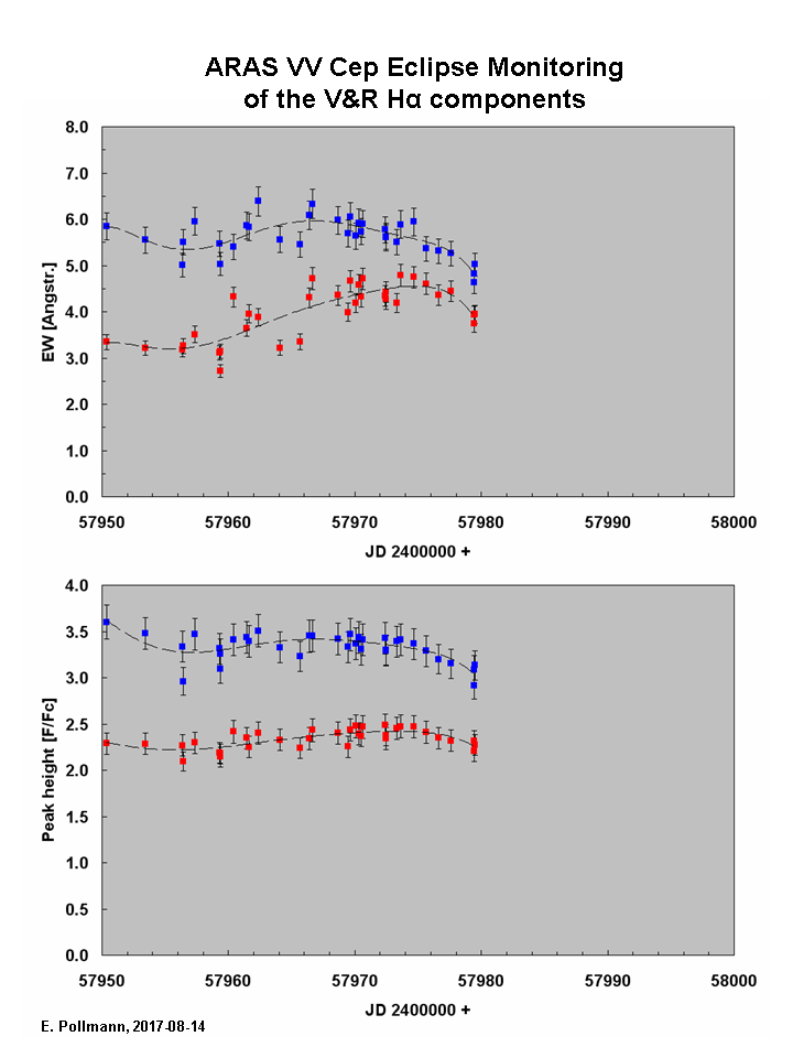

the diagram above is an enlargement the entire base line monitoring (the attached Fig.) of the group.
V & R Baseline.png (99.78 KiB) Viewed 40076 times
It should show more in detail the EW & PH behavoir during the last few days. Hope this helps for your understanding.
The left-hand side (= blue component) of the accretion disk of the B-star (which will be obscured first by the semitransparent atmosphere of the M-super giant in the line of sight) already shows a recognizable descent at JD 2457967, both in peak height and in EW.
On the other hand, the right-hand side of the accretion disk (= red component) shows a time-delayed start of coverage at JD 2457976 (also in peak height and EW).
However, it would be to early, to make statements about the size of the disk with this (vague) temporal difference and the system radial velocity.
Ernst

Hi Ernst,
Ernst Pollmann wrote:However, it would be to early, to make statements about the size of the disk with this (vague) temporal difference and the system radial velocity.
I agree. So far, the EW looks more likely correlated with each other, than anti-correlated. I would expect to find most difference in intensities of the two RV "wings".
Marc pointed out a more exhaustive region of hydrogen. This is something I also would expect. It will be interesting to see, if there will remain a blue and red component of the emission in the line of sight during total eclipse. This is something we also observe with planetary nebula or bubble like H-II shells or shockwaves of stellar winds: doubled line profiles from the surfaces of the gas shells. This is indicating two "planes" of a "bubble" with opposite direction of the radial velocities of the surface along the line of sight. This is not caused by the rotation of the disk, but should show a different profile (probably more sharp). I'm curious what we will find during total eclipse.
It will be nice to study changes of the line profile instead of presenting an integrated value, like EW or intensity.
