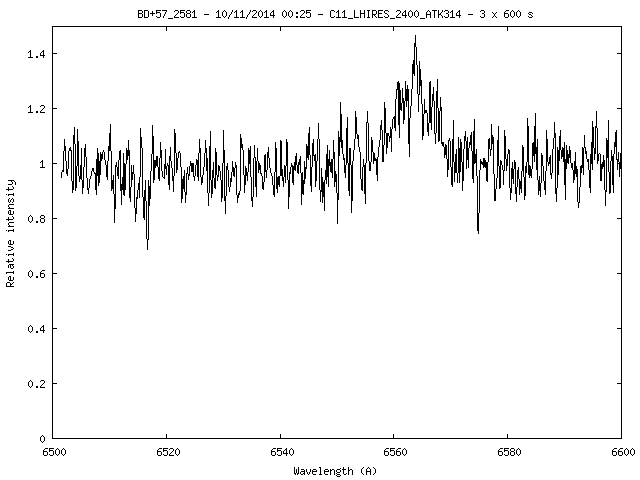

Re: 9 stars looks new Be, to be confirm in High resolution
Posted: Mon Nov 10, 2014 11:03 pm
BD+57 2581 emission confirmed at high resolution (short observation during gap in clouds so poor SNR)
