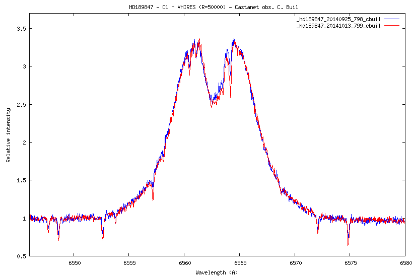

Posts: 1432
Re: HD189847 in emission
Also for me, two observations of HD189847 in HR mode (R=50000). One hour exposure VHIRES + C11. No significant change for the two dates.
