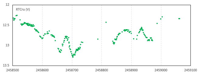

Juan Luna - CONICET-Universidad de Buenos Aires, Instituto de Astronom´ıa y Fısica del Espacio (IAFE) - draws out attention on a brightening of the symbiotic star RT Cru:
I would like to call the ARAS observers attention and encourage them to follow spectroscopically RT Cru, given that it is recovering from the low state and we suspect that Halpha and other emission lines should appear now or soon.
Send spectra to francoismathieu.teyssier at bbox.fr for inclusion in the database:
http://www.astrosurf.com/aras/Aras_Data ... /RTCru.htm
AAVSO lightcurve:
Thanks

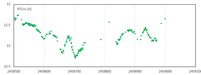

Juan Luna is recalling his request of spectra of RT Cru.
RT Cru is now observable in the morning sky for southern observers.
It remains at high luminosity (~ 12.3) according to recent observations in AAVSO data:
Comments from Juan:
During the last month or so, the Swift BAT flux has been steadily increasing and is coming out of the minimum that started about 1-2 years ago. Spectra now and for the next 6 months will be really useful as this is an opportunity that might happen again in ~10 years (if this is indeed periodic as we suspect).
We expect that the optical spectra should have strong Halpha and may be other emission lines.
Thanks for your help and best regards
-Juan
