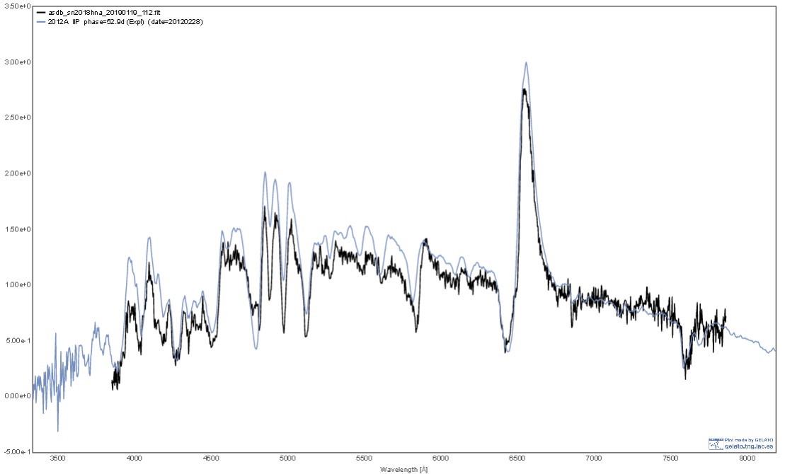

After almost 2 months of this SN's discovery, last night I've put it on the list as the 2nd larger target for the case if weather allows (30 cm f/4 Newton, Alpy 600, 18 micron slit, ATIK 414, 3 x 1800 sec, 2019.01.19.112, R~670), cutting Gelato's comparison as the 2nd match:
Gelato says 100% type II, however much more type IIP matches. With SN2012 (Type IIP) it estimates phase~50d that is close to the reality, with 1st match 1994N (Type II only) it tells 35.6d. Looking at these matches, my speculation that it's more like Type IIP, though not understanding classification system enough yet.

Attaching the fit:
asdb_sn2018hna_20190119_112.zip

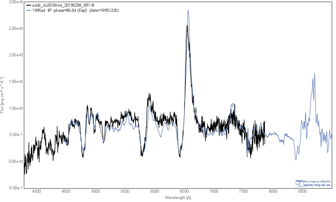

Despite its unusual very slow rise to maximum (~80 days) , the spectrum still closely matches match that of a normal type IIP SN at the same age. See attached ALPY 600 spectrum and example GELATO match

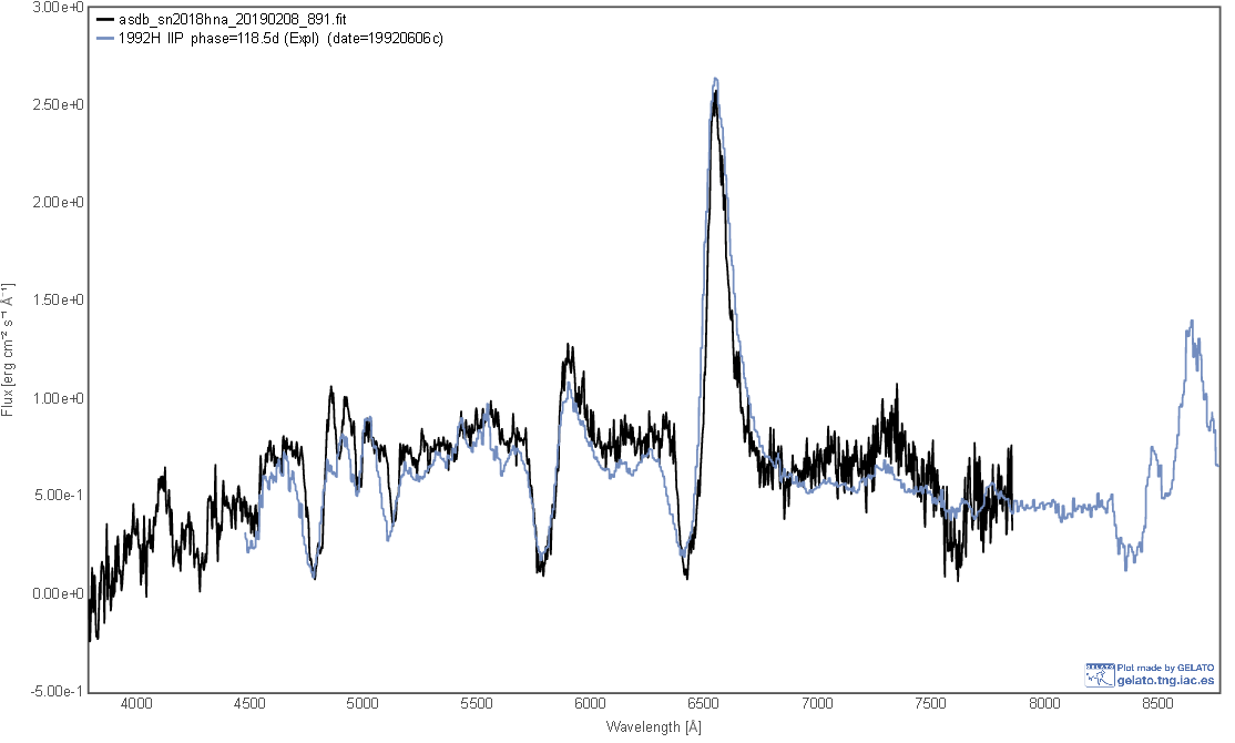

Here is my result (6 x 1800 sec) from last night, after spending 3 weeks without usable weekend-sky:

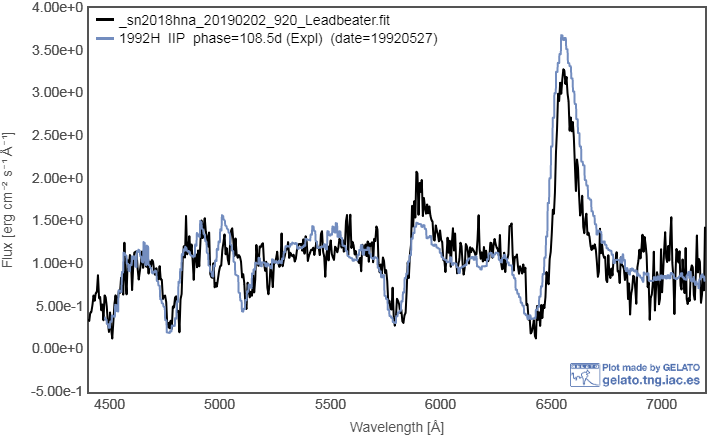

Althoguh Gelato offers the SN 1992H IIP even to me as a first match, I believe the Balmer velocities - with the blue end altogether - matching so perfectly, unlike 1992H that is showing well elaborated RV differences.
1995ad telling Phase=96.8d, whilst the 1992H match shows Phase=118.5d:
asdb_sn2018hna_20190208_891.zip

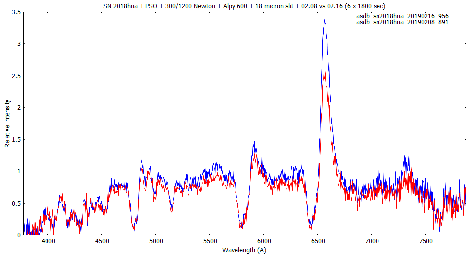

Fresh result from this weekend, no big change except the H-alpha peak increase:
- Peter
asdb_sn2018hna_20190216_956.zip
