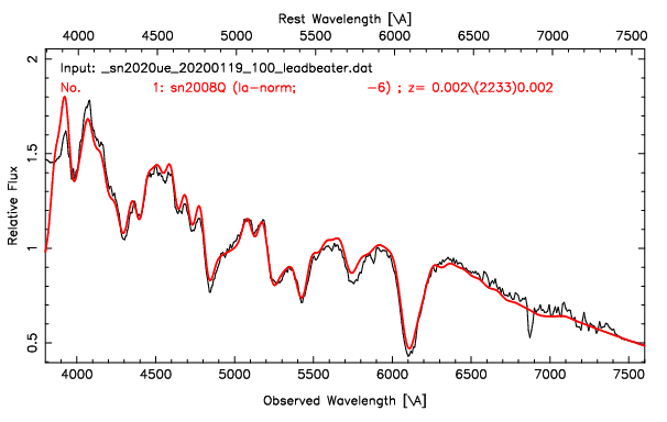

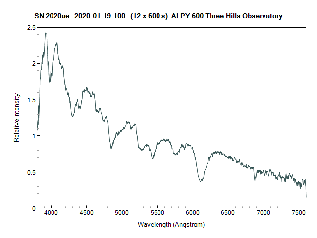

Here is a high SNR spectrum from last night using the ALPY600.
which gives and excellent detailed match in SNID to several type Ia supernovae still a few days from maximum eg

Previous to shooting this object in NGC 4636, I took a quick shot of Denebola (A3V) for my image response curve and got this spectrum of SN2020ue:
Very interesting spectrum and as previously mentioned, its probably before brightest light. I need to set my C-11/Photometry scope on this
object over the next 2 weeks to get BVRI calibrated magnitudes of this bright SN. As usual, (except for the telluric OII) all identified spectral
lines are (very) speculative!

Don't forget to identify lines you have to take into account the redshift of the galaxy and for absorption lines the blue shift due to the velocity of the explosion so the lines are very broad and can end up a long way from their rest wavelength. To get you started, the deep absorption "line" at ~6100A is Si II (rest wavelength 6355A) and is the result of the thermonuclear explosion and the main identifying feature of type Ia supernovae. You can use this to roughly calculate the current explosion velocity which reduces with time as we see deeper into the ejected material. (There is a good thread on here somewhere which follows the evolution of a type Ia in detail.)
The spectrum taken using Seimei 3.8m - KOOLS in TNS which was used to classify it is corrupted by some very high values so does not display properly there but attached is a corrected version to compare with the current spectra. The changes since then are quite dramatic, though the Si II line is still clear, just less blueshifted now

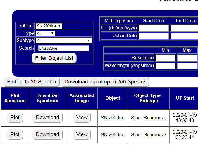

Posted: Fri Jan 24, 2020 12:38 am
Hi James
Note the correct designation is SN 2020ue not SN2020ue (mind the gap ! I sometimes forget too) I had already registered SN 2020ue as a new object in the BAA database so I have added SN2020ue as an alias so either designation will now call up all the spectra
