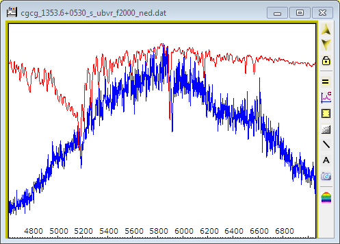

Stellar populations in elliptical galaxies are generally old so the integrated spectrum tends to look like a K star. The galaxy redshift is small but should be detectable in your spectrum so we can use this to distinguish between the galaxy and a foreground star. The Na D line appears to be at the galaxy redshift in your comparison with the redshifted K star but Na can also come from interstellar dust so may not be reliable. A better comparison is the Mg triplet at ~5175A which should be redshifted by ~20A if the target is in the galaxy.
There is a rather poor non response corrected spectrum of NGC5363 in NED
https://ned.ipac.caltech.edu/results?so ... NGC_5363_2
Here it is overplotted with Pickles K3v. The redshift in the Mg triplet is clear compared with the rest K3 spectrum.
Re: 2020leu - Supernova in NGC 5363
Posted: Tue Jun 02, 2020 11:27 am
Here is a roughly rectified VSpec etc compatible dat file version if you want to compare it with your spectrum. (note it is of the galaxy core so shows some H alpha emission)
