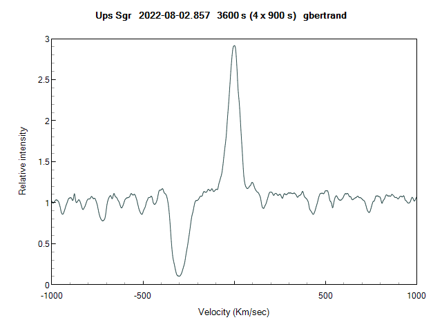

Here a recent (from a few minutes ago) hight resolution spectrum of Ups Sgr.
There is indeed an absorption on the blue wing of the h-alpha line...
If you have any explanations regarding this particular profile, I'm interested!

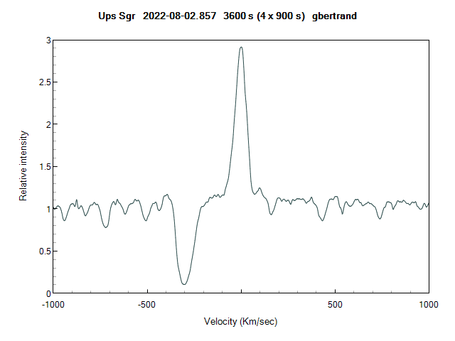

Great spectrum ! Sorry I do not know any more about this rather strange system. I cleaned up the telluric lines and produced a velocity plot from your spectrum.
Assuming the emission is centred at the H alpha rest wavelength, the centre of the absorption line is at -300km/s. It is remarkable how much the emission and absorption are separated. Not like the usual P Cygni profile.

According to this reference from 1967 (posted by MWR on cloudy nights) this is seen for 40 days during the 138 day orbit of the binary and they suggest a mechanism

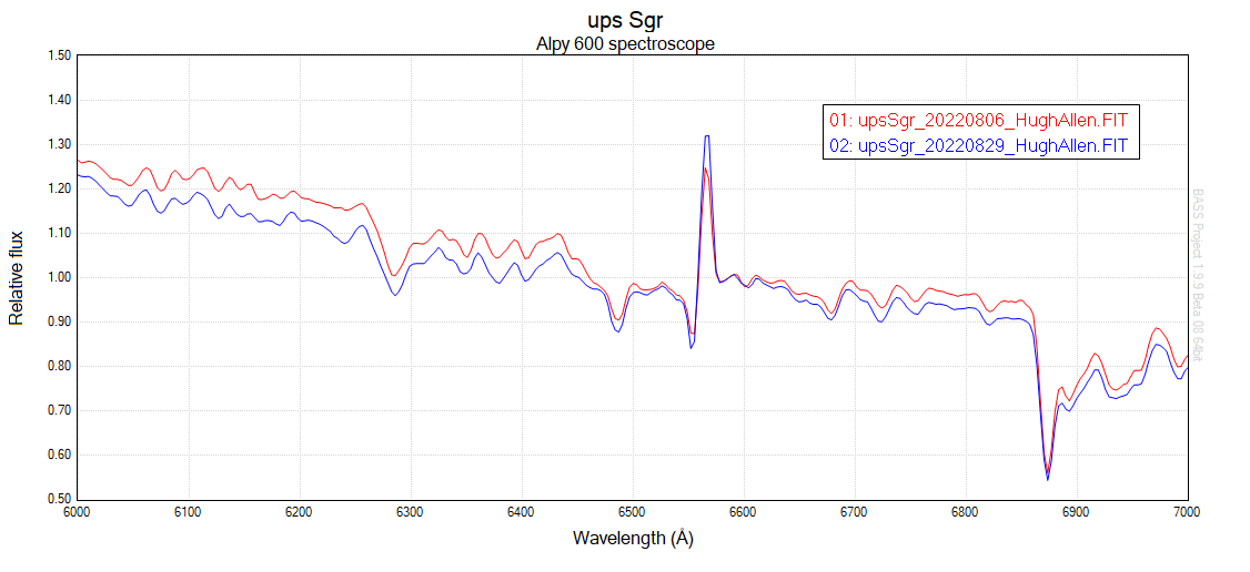

by HughAllen

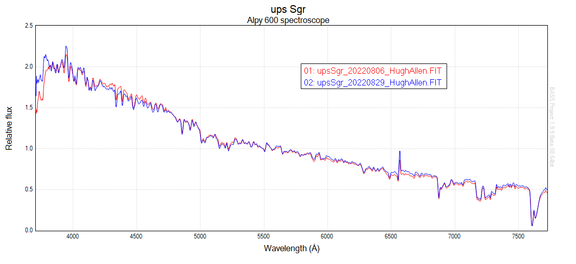

Thanks Robin for highlighting this interesting star. Even at the low resolution of my Alpy 600 the apparent P Cygni profile is quite distinct, although at this resolution not the plateau between the Hα emission and absorption visible in Guillaume's high resolution spectrum. For such a hot star the spectrum is unusually full of relatively strong absorption lines. It would be intersting to catch another spectrum in a month's time if that's possible at such a low altitude
Hugh

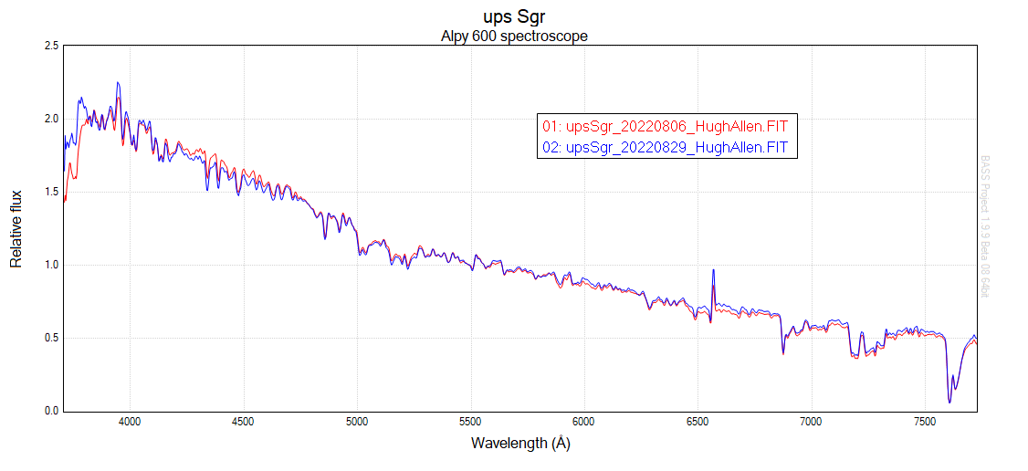

Re: Changes is Ups Sgr spectrum ?
Posted: Fri Sep 02, 2022 7:27 am
by HughAllen
That's a beautiful Doppler shift between your high resolution spectra Guillaume.
I captured another Alpy spectrum on 29th August that shows no sign yet of any weakening in the Hα absorption feature. Here's a comparison with my spectrum taken 23 days previously:
Full wavelength range normalised at 5550-5560 Å:
Zoom around Hα normalised at 6580-6590 Å:

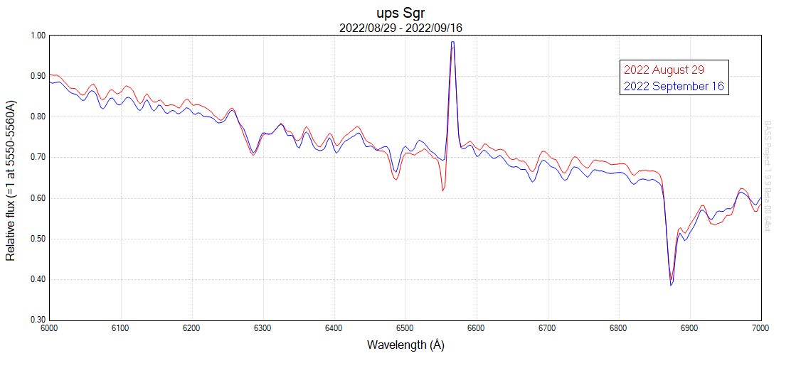

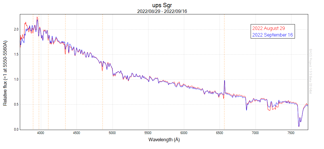

Posted: Sun Sep 18, 2022 9:15 am
by HughAllen
I captured another Alpy spectrum of ups Sgr on September 16th which shows that the blue shifted Hα absorption has now faded compared to the last spectrum I captured on August 29th:

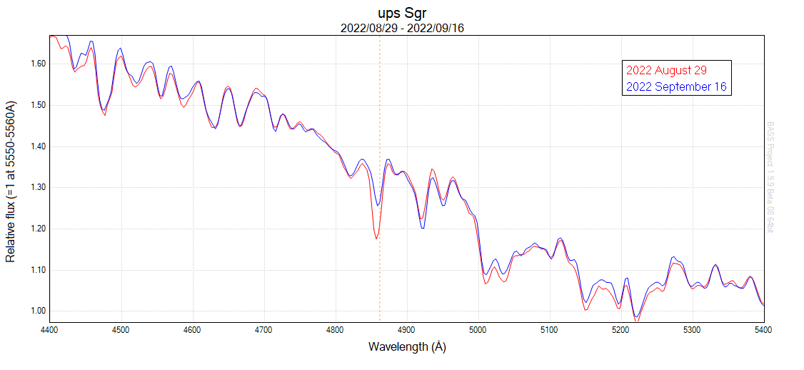

All of the hydrogen Balmer lines appear to have weakend between these dates, and they all show a significant blue shift. The Hβ line provides a good example:
upsSgr 2022.08.29-16.09 Hbeta zoom.png (51.5 KiB) Viewed 29624 times
