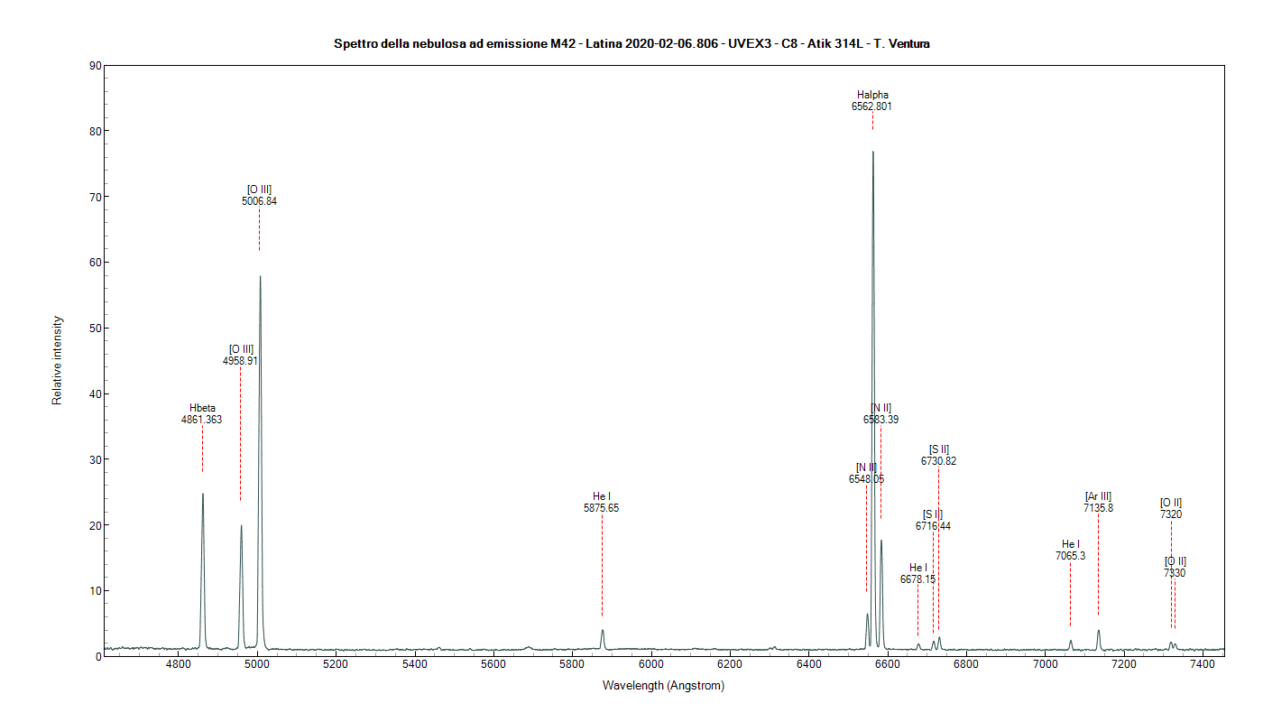

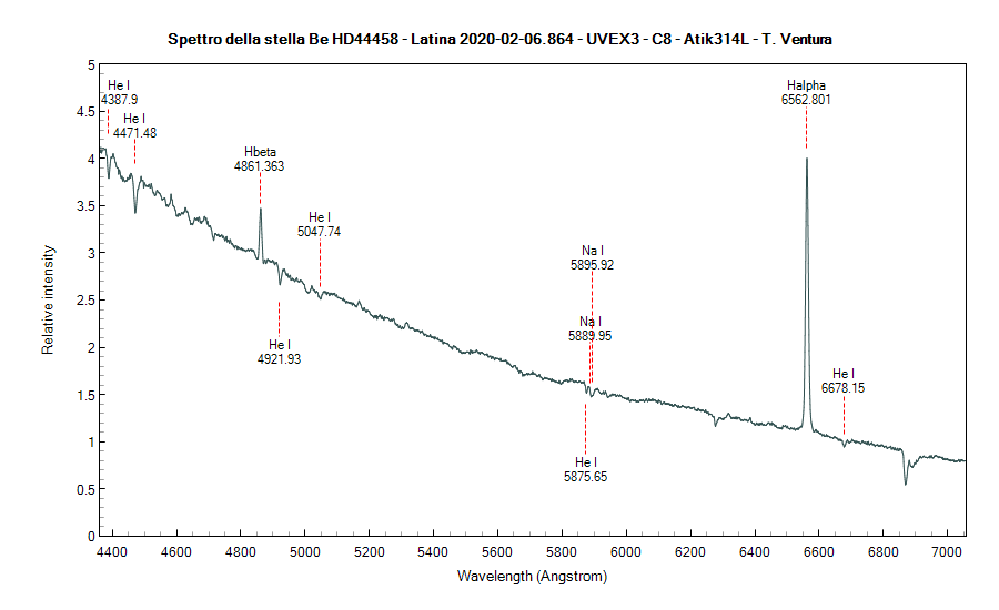

Hi everyone, I introduce myself, I am a fan of spectroscopy, I live in Italy in the city of Latina. I undertook the construction of the UVEX3 referring to the Cristian Buill project. I must say that it was difficult to optimize this optical scheme, however I think I did it. I put some profiles on your impressions.

Re: Experience with UVEX3
Posted: Mon Feb 10, 2020 8:58 pm
Excellent. Congratulations.
[S II] well separated in M42 spectrum
All the best
Posted: Thu Feb 13, 2020 1:20 am
Very excellent Antonino. The spectrograph seem very well adjusted because the symetric aspect of emission line (very limited coma).
Also, fine correction of the instrumental radiometric response. Your spectrograph is really operational!

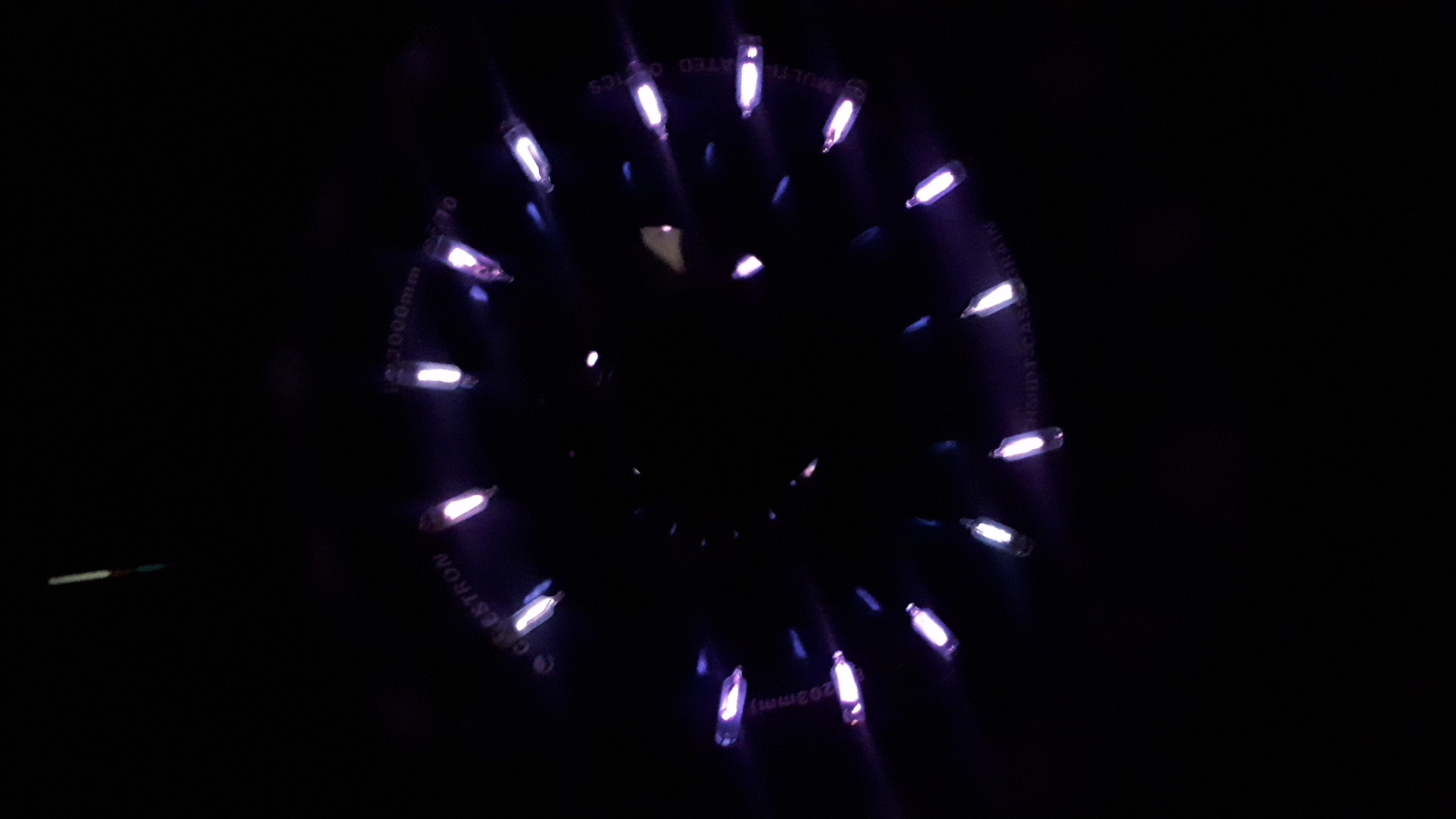

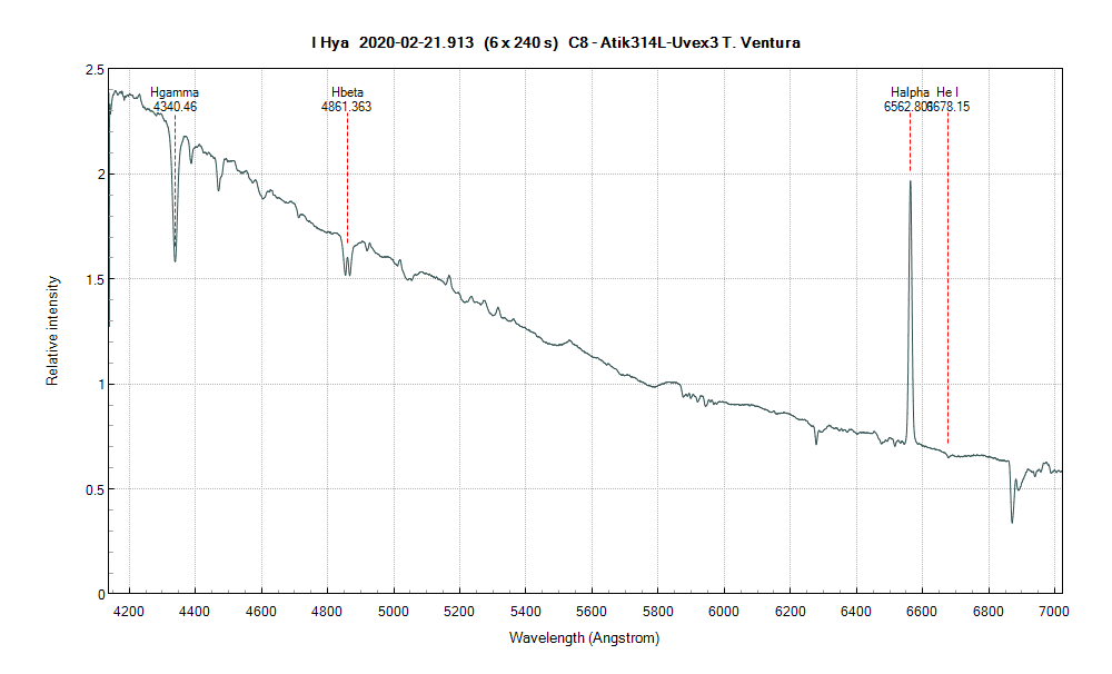

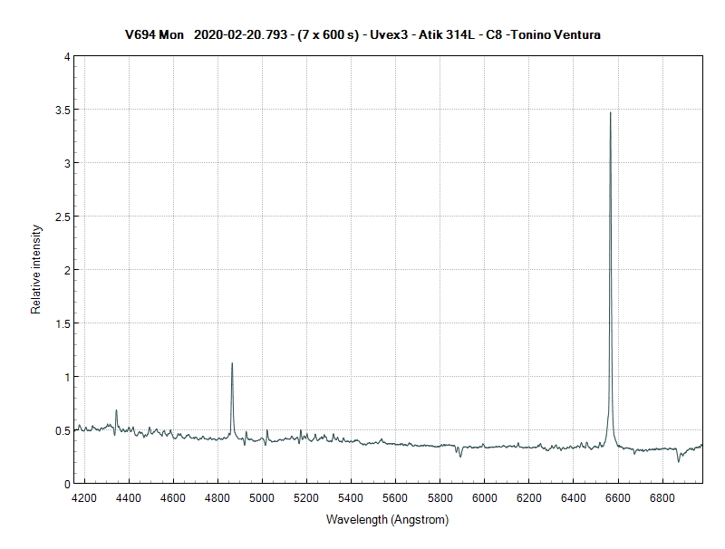

Good evening everyone. Two more observations with the self-built Uvex to which a 300l / mm grating is installed. For the calibration of the spectrum I used Relco lamps that are located inside the starters of the neon lamps. I placed these inside the lens hood along the internal circumference. I attach the profiles of the V694 Mon, Be I Hya and photos

An ingenious arrangement of the multiple relco argon lamps! What exposure length do you need for them?
Perhaps a polished aluminium or stainless lid over the telescope during calibration could reflect more of their light inwards and eliminate any streetlight pollution.

by Antonino Ventura
usually use a 180s exposure but also with 120s it is fine. Good idea a polished lid.
Posted: Thu Feb 27, 2020 8:43 pm
by Antonino Ventura
Hi Hamish. Previously I forgot to attach a frame of the Relco lamps used for calibration positioned on the inner circumference of the lens hood. Here I used a time of 120s.
Regards
