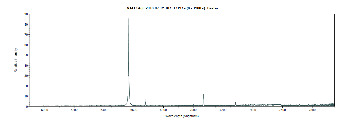

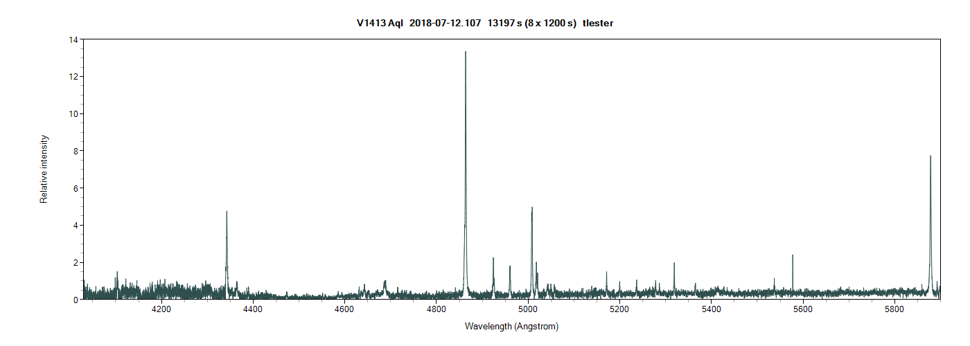

Here is my try at V1413 Aql with echelle spectroscopy. Difficult as the current V Mag is approx. 12.5 to 13 according to AAVSO.

A difficult target at that luminosity. Good result!
