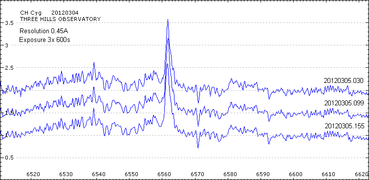

Here are my tests at H alpha from last night. It is M7, so much brighter at H alpha. A straightforward target for a LHIRES with 2400 grating

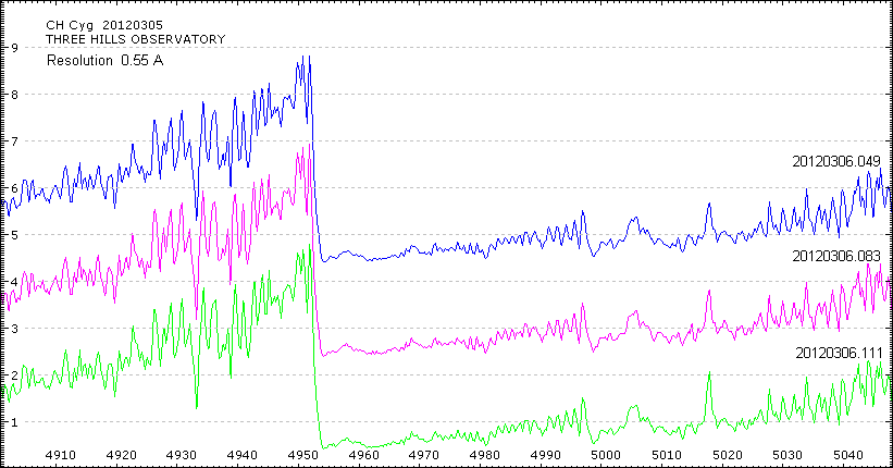

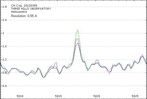

Here is the O[III] region. The spectra are again very complex but repeatable except for the emission line at ~5017A which appeared to increase significantly over the 2 hours I observed it.
Wvelength calibation was done using a mixture of Ne, Ar and Xe lines from a "Filly dot" lamp. I could not identify enough faint lines to do a good calibration using the internal neon.

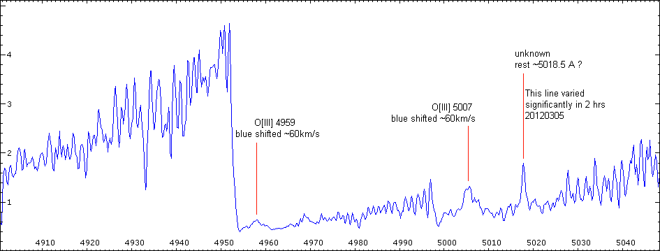

Attached is the O[III] spectrum with the emission lines marked (CH Cyg has an RV of -60km/s)
I have had some feedback from Margarita Karovska. To cover all the lines Margarita is interested in, we need someone with an eShel to take some spectra or perhaps even a LISA. The HST/Chandra observations are next week.
Thanks

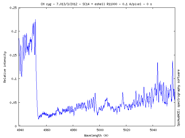

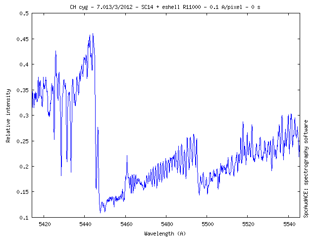

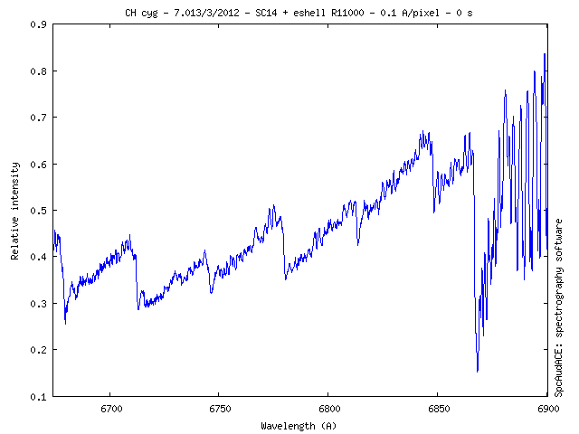

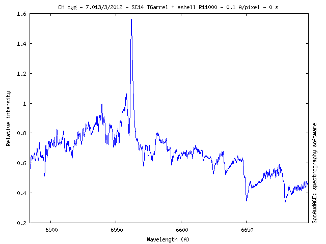

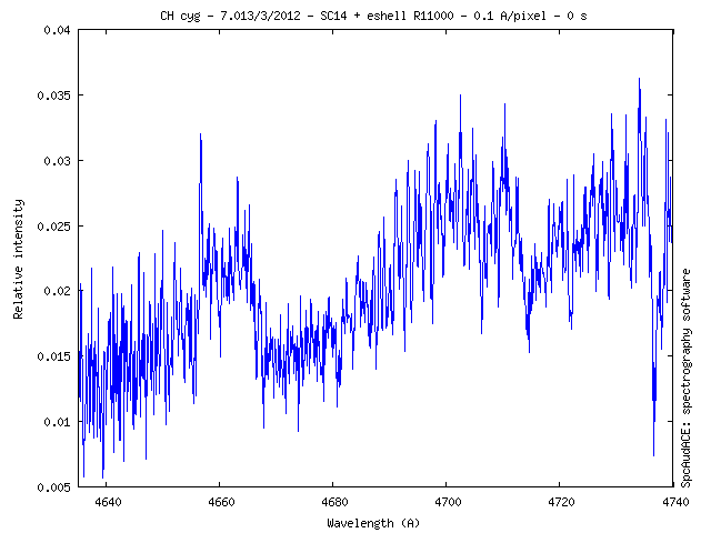

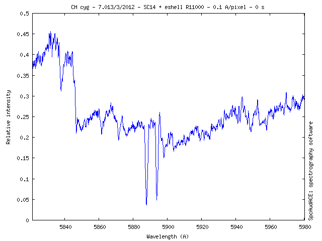

Here is my last observation a 3X1200s exposure with my eshell setup (R10000). This star was relatively low at the moment of exposure, 17° but still have strong spectral features easy to spot on the yellow/red régions. It is more difficult due to absorption in the blue. I have sent the spectra, individual orders, directly to Margarita. We can extend coverage in NIR if needed.
Nice object.
Nice object.
- continnuum
- ch_cyg_20120307_013_continuum.png (6.51 KiB) Viewed 42639 times
- HeI 5876
- ch_cyg_20120307_013_HeI5876.png (6.28 KiB) Viewed 42639 times
- [SII]6731
- ch_cyg_20120307_013_[SII]6731.png (6.15 KiB) Viewed 42639 times
- HeII 4686
- ch_cyg_20120307_013_HeII4686.png (7.11 KiB) Viewed 42639 times
- [OIII] 5007
- ch_cyg_20120307_013_[OIII]5007.png (5.96 KiB) Viewed 42639 times
- H alpha
- ch_cyg_20120307_013_Halpha.png (6.15 KiB) Viewed 42639 times

Attached is my heliocentric O[III] region spectrum from the previous night (fits, mean of 3) How does it compare? Has the unidentified emission at ~5018 A changed any more?

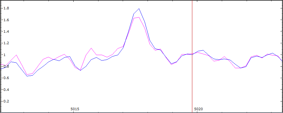

- Posts: 193
- Location: Montpellier
Re: AAVSO Alert Notice 454: Monitoring of CH Cyg requested
It match quite well, but my spectra is more noisy than yours. No differences seen.
- Posts: 193
Very sensitive to normalisation. I don't think it moves.
- Blue Robin Pink me
- 5017 comp.png (13.1 KiB) Viewed 42622 times
