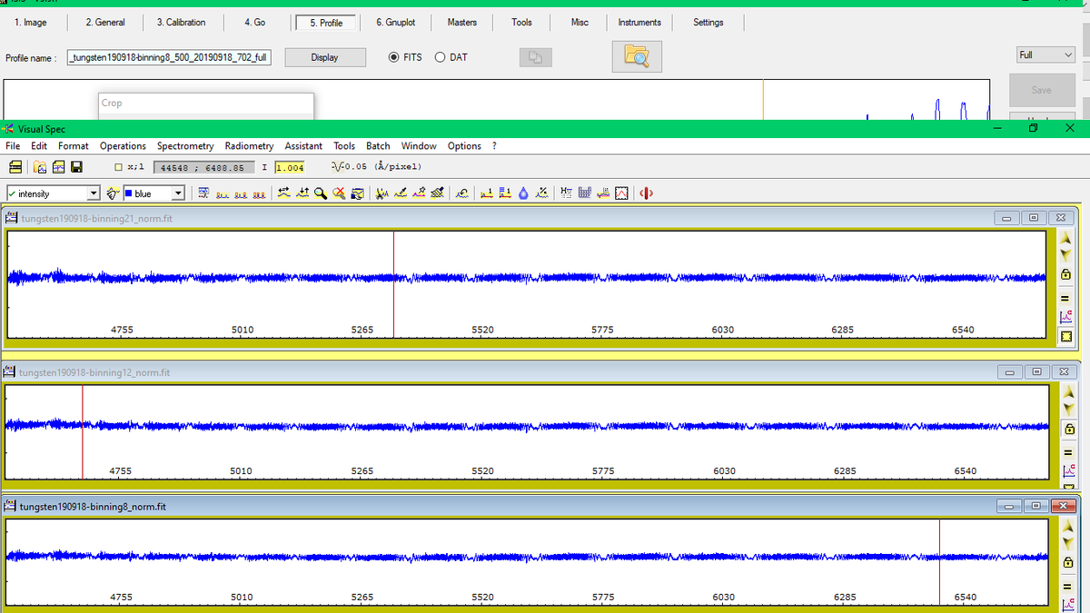

PostPosted: Sat Nov 02, 2019 4:38 pm
by Berthold Stober
I tried to reduce those waves bei changing the "binning zone" in ISIS but nothing
Hello to all,
I found, that ISIS seems to create strange effects, visible by extracting a 2D flat_tungsten. Look the adnex please. If I extract the same flat with midas those "fringes" are not visible!
Could anyone tll me something about this phenomena?
cheers Berthold

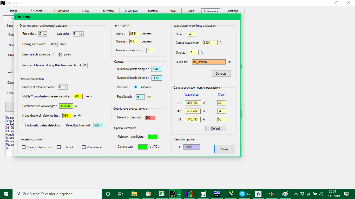

I suggest that you publish the aspect of the (2D) image of a typical tungsten spectrum and of a spectrum of the thorium-argon lamp.
I suspect that you work in 2x2 binning with your camera. That's right ? I's an Atik460EX model?
A screenshot of the "eShel tab" and the "eShel-> Setting tab" has also well come.
(Note also that using the calibration tungsten lamp is not the best way to evaluate the response of your spectrograph: result is depending, for example, on how the science fiber is illuminated by the light coming from the calibration fiber in the guidance module - did you realize this centering by observing with the guidance camera?).

Ok, it could be that the light from the 200 mue fiber is not perfect centered over the pinhole, But!!!
I know a professional Astromer who reduced the SAME files with Midas and there is nothing to see from those "fringes" . Therefore It is nearly not possible that those phenomena are caused by my equipment.
This astronomer told me, that the "slit with" of the software is to small. One can change this slit with in Midas but not as fare I can see it is possible to change it in ISIS (?)

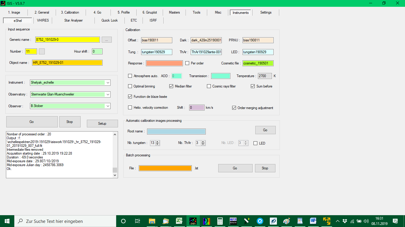

Thanks for the infos. For complete, capture and publish a screenshot of the main "Instrument - eShel" tab.
Re: Bad efficiency of the eShel from shelyak
PostPosted: Fri Nov 08, 2019 3:38 pm
by Berthold Stober
Bonjour Christian,
voila l'image d'ecran. Est ce que ca suffit pour le moment? J'ai envoye les 2D frames via wetransfer.
Berthold

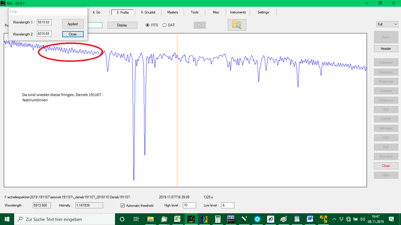

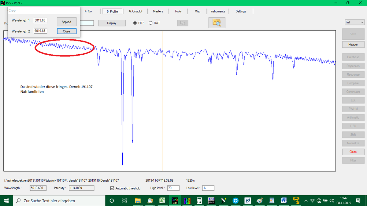

PostPosted: Fri Nov 08, 2019 7:01 pm
by Berthold Stober
those "fringes" are not ok
