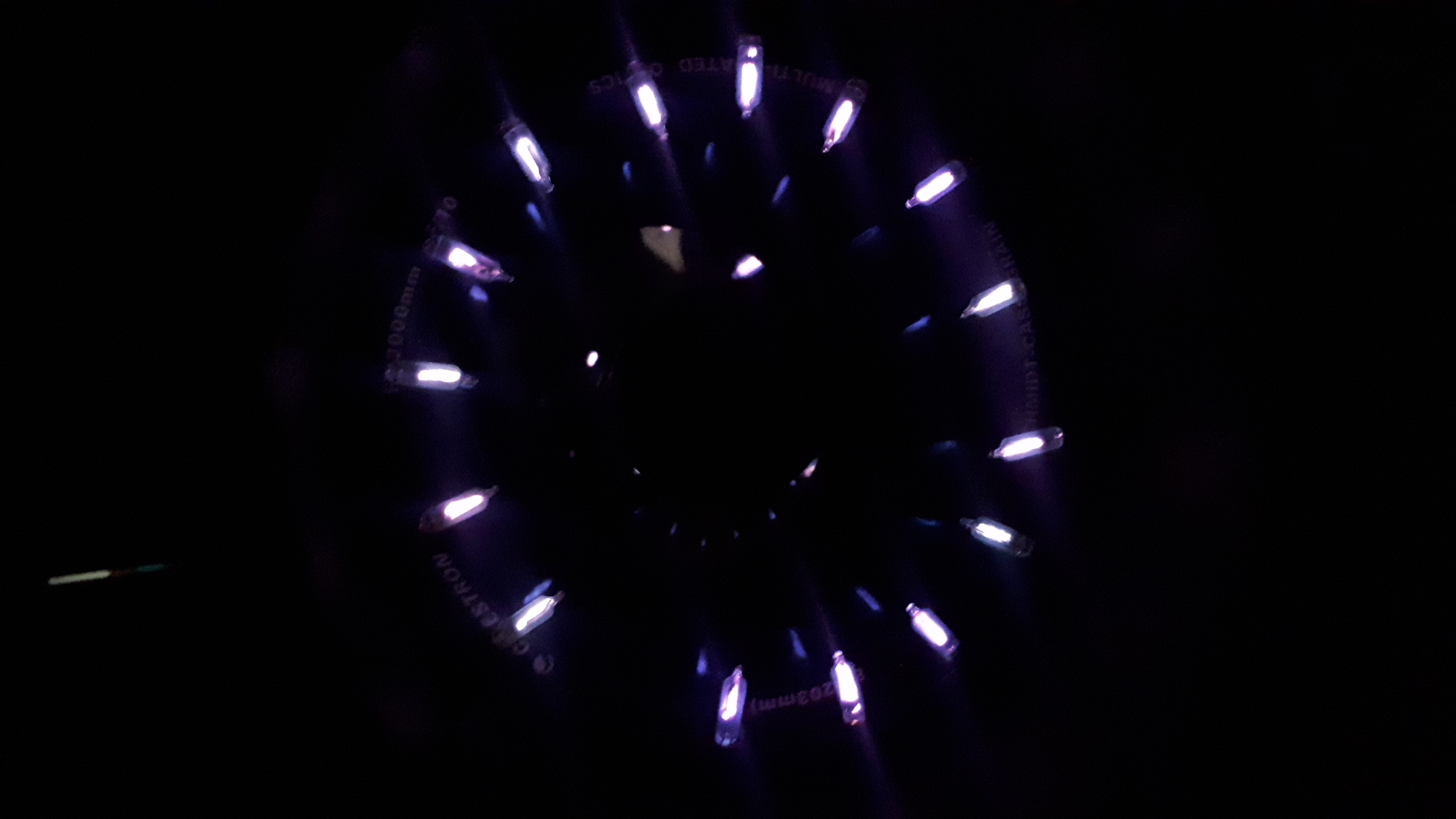

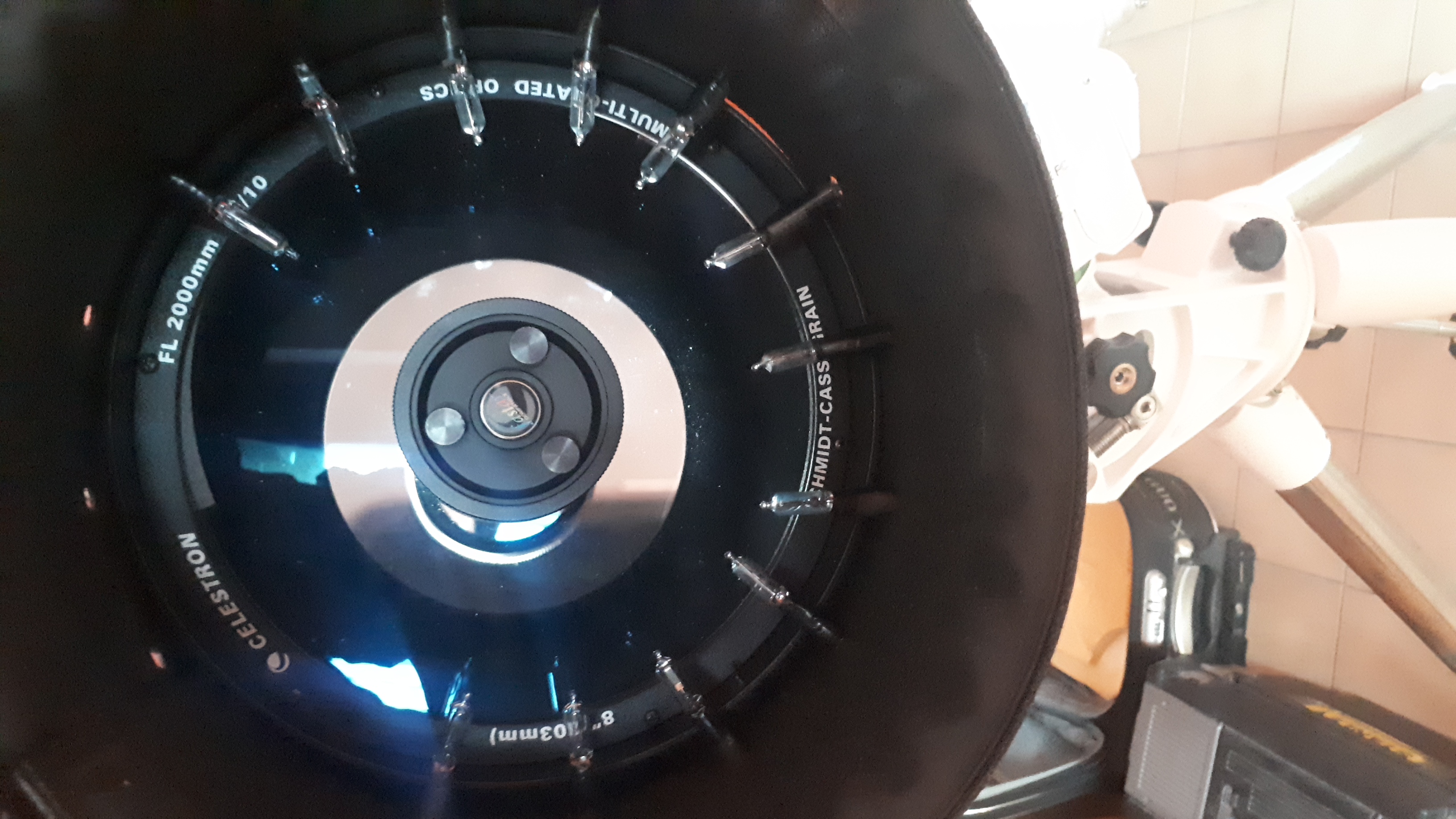

Good evening everyone. Two more observations with the self-built Uvex to which a 300l / mm grating is installed. For the calibration of the spectrum I used Relco lamps that are located inside the starters of the neon lamps. I placed these inside the lens hood along the internal circumference. I attach the profiles of the V694 Mon, Be I Hya and photos

An ingenious arrangement of the multiple relco argon lamps! What exposure length do you need for them?
Perhaps a polished aluminium or stainless lid over the telescope during calibration could reflect more of their light inwards and eliminate any streetlight pollution.

usually use a 180s exposure but also with 120s it is fine. Good idea a polished lid.

Hi Hamish. Previously I forgot to attach a frame of the Relco lamps used for calibration positioned on the inner circumference of the lens hood. Here I used a time of 120s.
Regards
