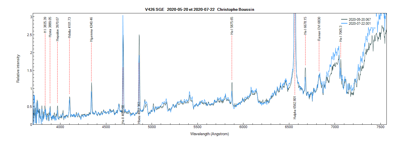

I obtained the following spectrum of V426 Sge the 22th of July at 00 h 01 TU with my Alpy 600 (resolution of 501, JJ = 2459052.5012) and an acquisition time of 65 min :
The comparison of the spectra shows a decrease in the relative intensities of the Balmer lines as well as those of the HeI lines.
The relative intensity of the HeII line at 4686A is now greater than that of the Hbeta line at 4861A.
The Raman band OVI at 6830 A remains unchanged since May 20.
