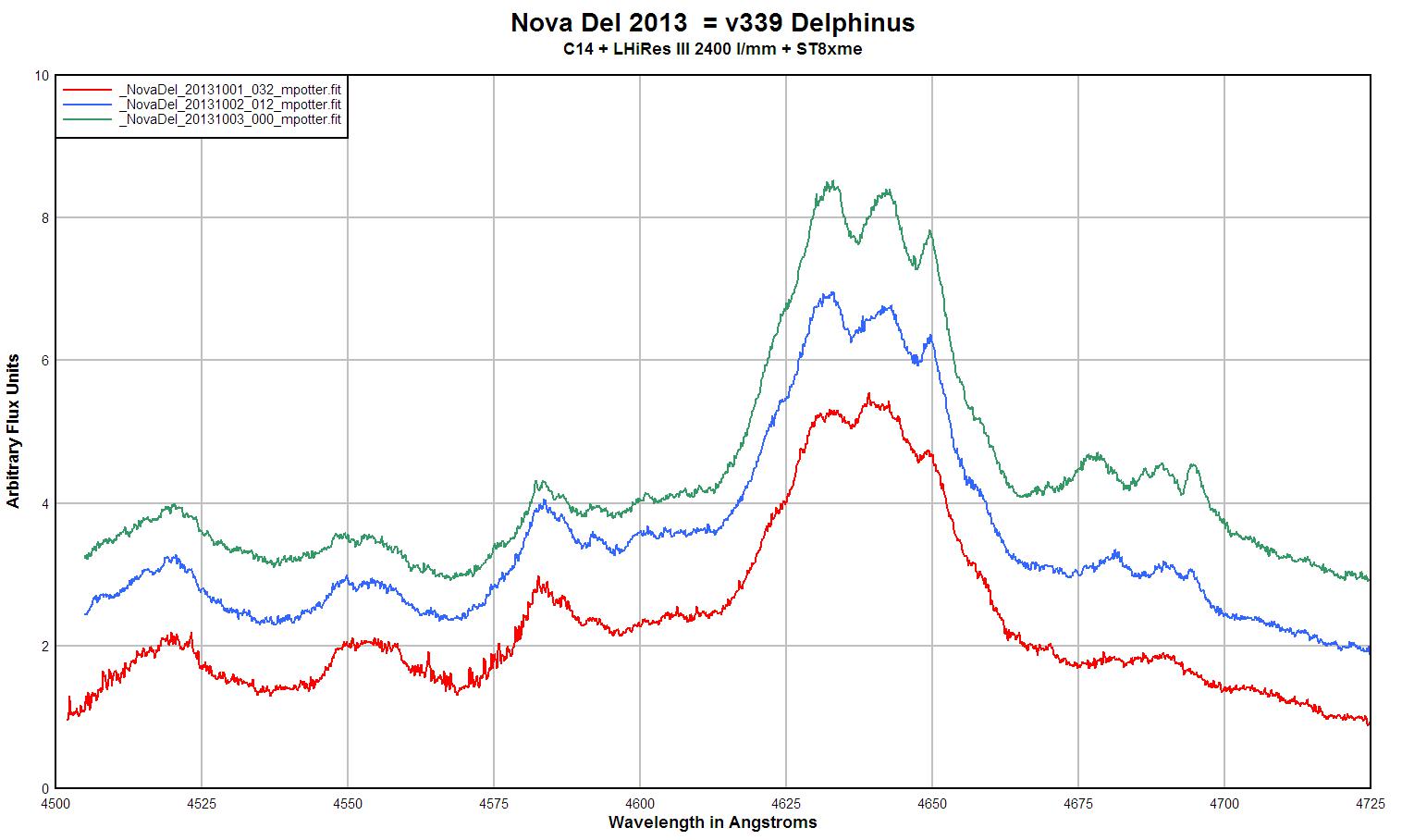

We've had a nice stretch of mostly clear nights lately so I've been able to get spectra on seven of the past eleven nights. Nice triple peaks on both N III 4641 and He II 4686. Just a very crude measurement of the blue and red-shifted peaks compared to the center gives an expansion velocity of about 550 km/s. Sadly the nova is getting fainter and I'm not likely to be able to get many (or any?) more spectra at this resolution. Not only that but I only have about three hours from the time it gets dark until the time the nova passes behind the maple tree in my back yard.
- test10.png (23.33 KiB) Viewed 67591 times
Mike Potter

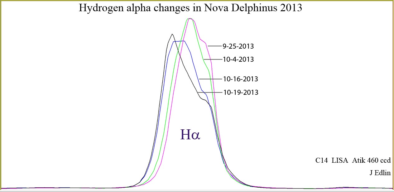

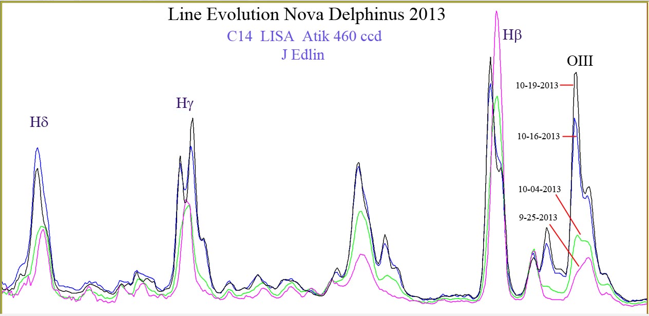

- Posts: 13
- Joined: Mon Oct 10, 2011 3:22 am
I have been following the nova as often as weather permits. The blue wing of hydrogen lines are evolving rapidly with marked blue shift. This was also noticed by Paolo. See my quick graphs from spectra over last 2 weeks. Very interesting changes!! These are from LISA spectrograph.
Jim
Jim
