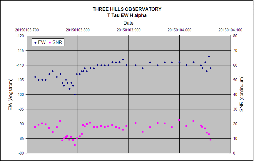

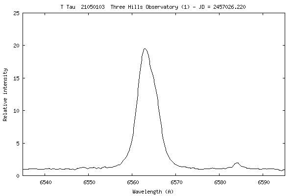

Re: Observation request: T Tau early in January
Posted: Mon Jan 05, 2015 8:09 pm
An animation of 8 hours of continuous observation at R ~5500 and 5 min cadence from 3rd Jan and a plot of the EW. There is some variation, though the lowest EW point coincides with a period of lower SNR due to thin cloud.
