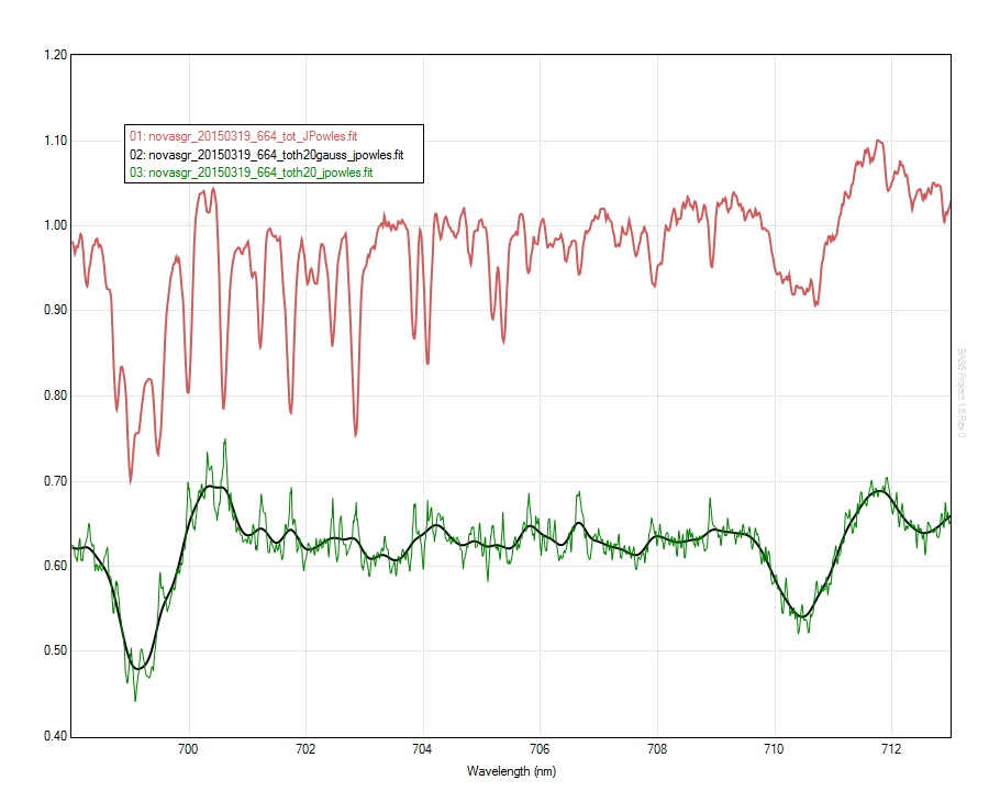

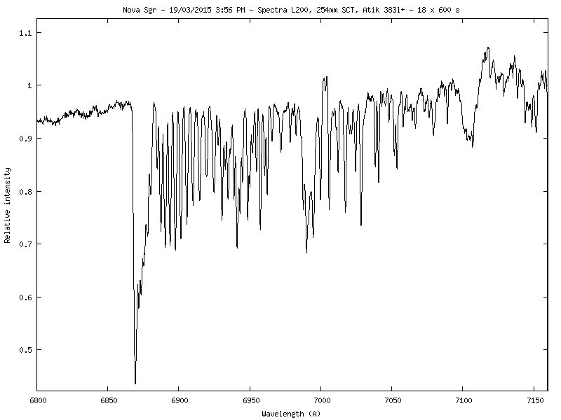

Posted: Sat Mar 21, 2015 7:14 am
by Jon
Here is a 3 hr spectrum from 19-3-2015, of the region 6800-7160, as requested by Steve Shore.
The OI line at 7003 and the CI line complex at 7115 are clearly visible, although the 7003 line is obscured by the heavy telluric lines. I've had a go at removing them, using the H2O tool in vspec and using the spectrum of the reference star I'm using (Phi Sgr). The tellrric-corrected spectrum is offset below, with a Gaussian filter applied to remove the artifacts.

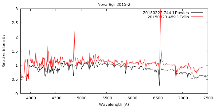

Posted: Mon Mar 23, 2015 6:24 pm
Comparison of Jonathan Powles and Jim Edlin spectra
Impressive evolution in less than one day :
The ejecta is turning thin.
Have a look on Fe II absorptions.
Congratulation for these nice and interesting spectra

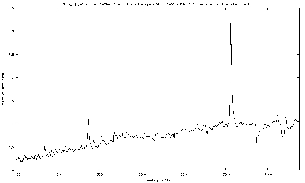

Re: Nova Sgr = PNV J18365700-2855420
Posted: Tue Mar 24, 2015 12:09 pm
by umberto sollecchia
0bserved spectrum of nova . All data are reported on graph frame.
Due to very low altitude of target above the horizon and irregular clouds presence it is possible that the continuum is not well corrected.
Posted: Wed Mar 25, 2015 6:03 am
Well done Unberto
Nice result at such an altitude
Of course, the spectrum is welcome in the data base
Regards,

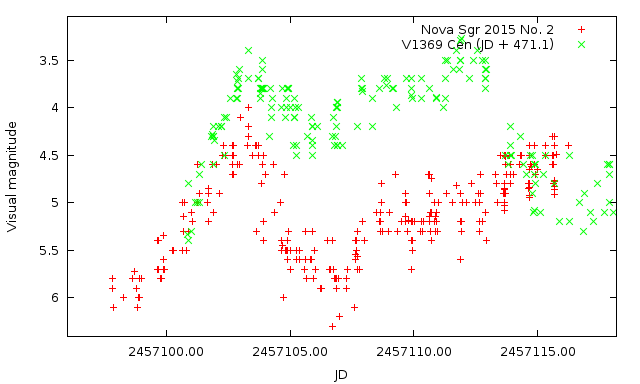

Posted: Sun Apr 05, 2015 5:04 am
by Malcolm Locke
I remember V1369 Cen going through a very similar re-brightening after the first maximum, so I thought I would plot the two light curves together.
They are so far remarkably similar. Nova Sgr is maybe a little slower in the oscillations, it will be interesting to see if the similarities continue over a longer period.
