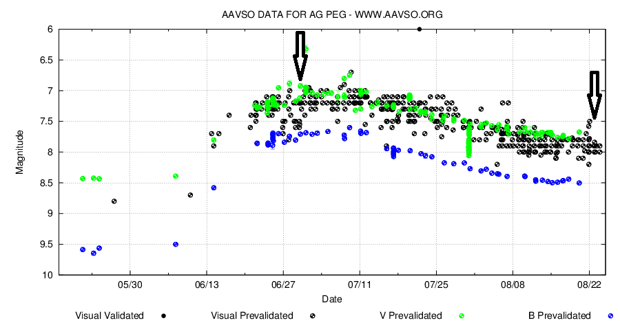

Posted: Mon Aug 24, 2015 11:12 pm
by Tim Lester
AG Peg for 2015-08-23 from 4270 to 5420 (R=6400) compared to my last result for this range on 2015-06-30, near its maximum.
Flux calibration based on the standard star HD209459 Vmag = 5.75.
AG Peg_AAVSO.png (55.44 KiB) Viewed 13013 times

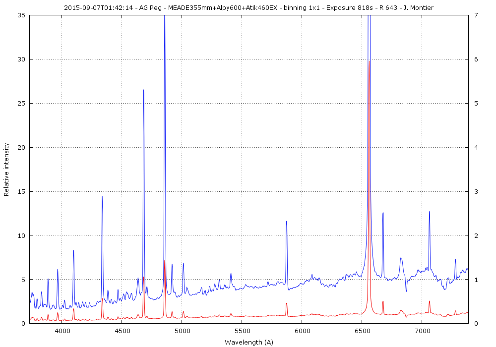

Posted: Mon Sep 07, 2015 1:02 pm
by Jacques Montier
Here is AG Peg spectrum of 2015/09/07 with Alpy600 (0.485 A/pix)

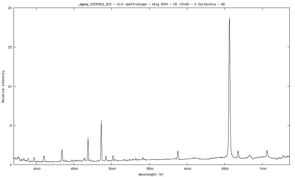

Posted: Thu Sep 24, 2015 8:12 pm
by umberto sollecchia
Salut, placez un profil de l'étoile observée dans la nuit du 21/09/2015.
Salutations à tous- Umberto
