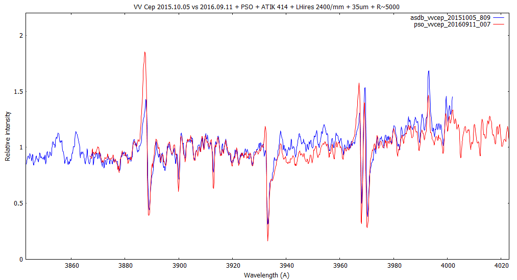

Posted: Mon Sep 12, 2016 8:29 pm
by Peter Somogyi
After 1 year, fresh result from this weekend - with the same LHires + 2400/mm grating - the only change is a new 12" Newton (the old was a 10"):
Emissions have changed somwhat, would be interesting to know why.
Used 2x2 binning, pixel intensity at approx. 2200 ADU / 10 minute. (Typical conversion for a 1x1 bin case to divide the ADU value per 4 above bias which is 300 ADU).
The new observation took 4 x 10 minute (with a Mu Cep 2 x 10 minute in between). Sky was not perfect, but was able to shoot close to zenith.
I do not have any ripple on the flat (in fact, flat patterns not even dependent on any wavelength...seeing the same low-order humps at the same place in red and green as well, just the dusts are much more defined). Hope the flat is valid (hence attaching 7 cep in the zip - it looks to be smooth), made the flat 3 x 1 minute average with the internal lamp.
Only the left 20% of the new spectrum gets less focused here by calibration.
Attaching a zip file with results and a Mu Cep, as I read it might be useful for experiments.
