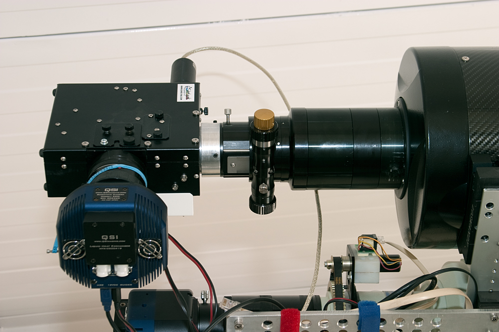

Francois Teyssier wrote:Hi Rainer,
Could you show us some same samples of your spectra.
I remember you've got good (very) results
Hi Francois,
Thanks for the Flowers :oops:
See below some recent spectrum images I have done and where I focused on approximately the 5000A to 6000A wavelength area. I am exposing now with a QSI520i with a Kodak KAI-2020M CCD chip to a maximum of about 32.000 ADU. The chip full well depth is 45.000 electrons. I do this because of V-Spec. I have done test going up to 60.000ADU (16bit depth) but V-Spec can not (¿ still or has it been changed ? :? ) process those images correctly as the spectrum is always overexposed and in other software it is OK.

Hi Francois,
No, Vega is from a few weeks earlier but Jupiter, Albireo and Markab are from 2 weeks ago, same weekend, with the new focusing workflow ...
OK, about the f/10 and f/6 difference, so it is 1 : 1.6 and then f/8 to f/5 is the same :mrgreen: which is my setup.
I am using an 8" Astrotech Ritchey-Chretien
http://www.astronomytechnologies.com/pr ... 77&c=10607
with the OptecInc NextGen 0.7x reducer
http://www.optecinc.com/astronomy/catalog/17409.htm
