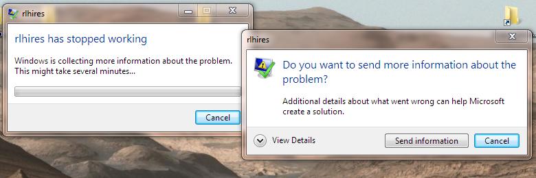

I cannot really help as I cannot get ISIS 5.6 to run at all. I just get this message

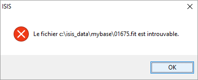

I've successfully downloaded ELODIE 3.1 and setup a mybase with the 3 Vega spectra (HD 172167) (01675.fits, 01676.fits and 01677.fits). I can plot them via the new Database button, but when I try to select them to use in a response calculation I get the below error message.
Error message
Error message
This makes me wonder whether I am missing something or if there is a bug.

I suspect a possible problem with the FITS extension. Normally if you select the .FIT extension
in the ISIS setup, the software can read the .FITS files of ELODIE 3.1 data base. You confirm: from the
Database button you can download the ELODIE 3.1 spectra ?
The problem is perhaps localized at the automatic radiometric calibration function level. I investigate.
But a VERY IMPORTANT point , I do not recommend to use ELODIE 3.1 from this calibration calibration tools
because the spectra are in absolute flux. A manual division of your target spectral profile
by a Elodie 3.1 spectrum --- after unity normalisation --- is preferred.

I confirm when using the database button I can download and display spectra. It was only in the Response then Select a Reference Spectra buttons where I was having a problem.
I was able to access the old "ELODIE - OHP" spectra by resaving them as ".fit" files in mybase and creating entries in the ".lst" files. So this gives me a way to use those spectra for response calibration. I think this could be a tricky step for new users though, so I don't know how easy it would be to add back the "ELODIE - OHP" button, or another set of high resolution spectra for use with the LHIRES III in due course. Though I may be missing something and there is an easy way I've missed!

OK I finally got v5.6 installed and working and installed LL_ELODIE_31_23 as "mybase"
