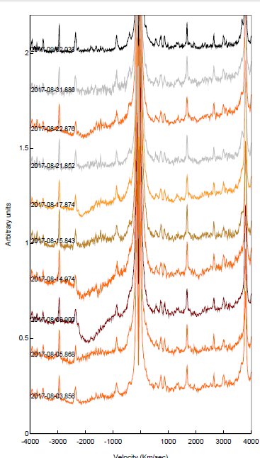

Posted: Sat Sep 16, 2017 11:20 am
From observations in August, both at low (Woody Sims and James Foster) and high resolution (Joan Guarro, Tim Lester, François Teyssier), strong absorptions in H beta and lower Balmer lines appear clearly with max velocities from -2000 to -3000 km/s (and perhaps more)
H beta profile from echelle spectra
