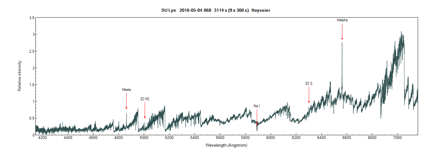

And also the main lines observed in symbiotics
In Plot Spectra (T Lester) you have a list of the brightest common lines. A very nice tool.
Commented spectrum when the emission lines were bright (orbital variations)

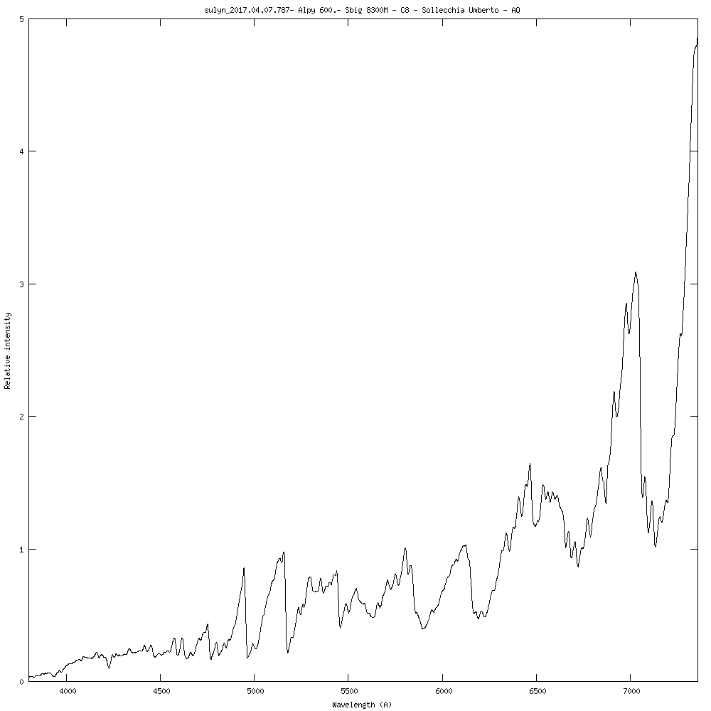

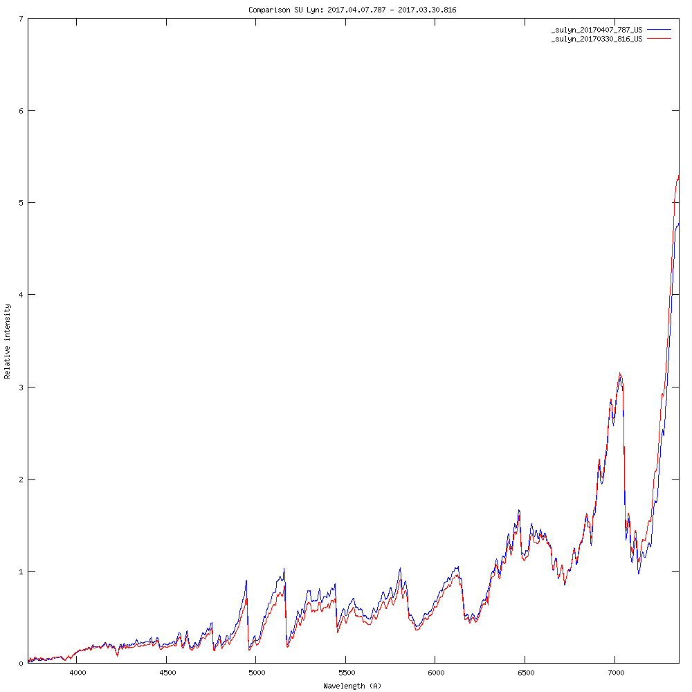

Salut, placez un nouveau profil spectral et une comparaison avec le jour 30/03/2017 et le jour 07-04-2017.Umberto
Profilo sulyn.png (9 KiB) Viewed 12072 times
