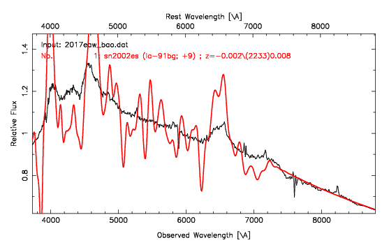

Congratulations on the spectrum Etienne. I think your result compares well with the professionals.
Paolo Berardi wrote: I don't know if SNID, the other tool for SN classification, provides the same performances.
The Chinese BAO team did not give any information on how they made the classification unfortunately.
EDIT: Another team using LOT used GELATO to predict type II
http://www.astronomerstelegram.org/?read=10374

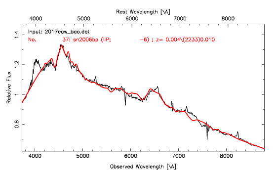

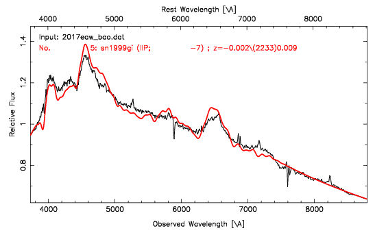

Usually I find SNID works better than GELATO but I tried the BAO spectrum with SNID and it favoured type 1a-91bg spectra at 9-17 days after maximum with good confidence. The fits do not look very good to me though and we know the supernova is younger than that :?
Here is the best fit according to SNID
The best type IIP fits look better to me though and the dates (6 and 7 days before maximum) are more sensible
I expect we will know who is right in a week or two

Hi Robin, thanks a lot for the info about SNID. Did you have to provide the reddening value or the tool automatically adjusts the continuum? If I have understood that correctly, SNID works offline, without a web connection. I'd like to install but I'm not know the Linux environment, I wonder if I could use it on Windows OS using a virtual machine.
The SNID best fit seems also to me related with the two type IIP SN (the profiles are almost identical). Maybe human judgement it is necessary sometime to discard possibile unlikely solutions. Also the SN age is an important constraint.

Paolo Berardi wrote: Did you have to provide the reddening value or the tool automatically adjusts the continuum? If I have understood that correctly, SNID works offline, without a web connection. I'd like to install but I'm not know the Linux environment, I wonder if I could use it on Windows OS using a virtual machine.
SNID "flattens" the spectra, effectively removing the continuum before measuring the correlation so extinction effects are eliminated and the program is just looking for matching features. (The spectra I posted are with continuum but you can also view the flattened spectra in SNID.) SNID then lists all the library spectra with a correlation over a certain threshold (a factor called rlap), looks which type (and sub type) the majority of these spectra are and reports this as the type if there is a clear majority of a particular type. You can see a typical example run in the manual here (section 3)
https://people.lam.fr/blondin.stephane/ ... howto.html
There are a lot of parameters which can be altered in the program but I just run with the default.
I am using an old spare laptop with a clean Ubuntu installation. (I am very impressed with how easy installing Ubuntu was. It ran without problems including wireless networking which I use to swap files with the windows laptop.) The installation instructions for SNID are quite good and I got it running after a bit of trial and error and some silly mistakes, not knowing much about linux, fortran compilers etc (I have also installed IRAF but I have yet to try using it)

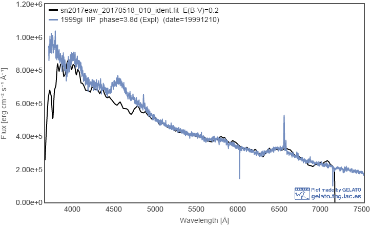

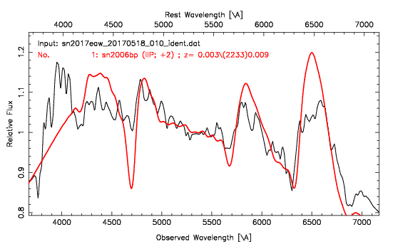

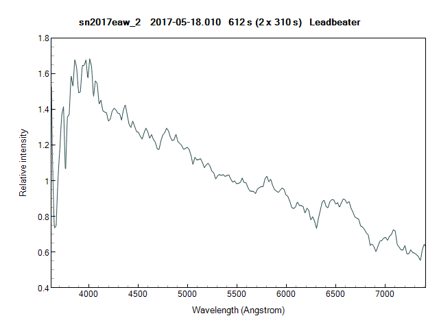

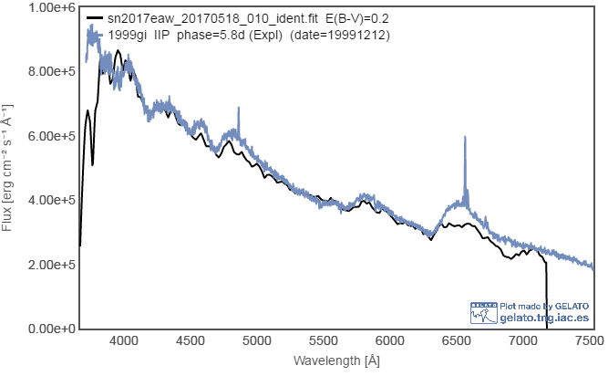

I was able to get just 10min exposure time on this object last night before the clouds arrived. It is a bright target for the modified ALPY 200 though so it was enough to get a good low resolution spectrum.
SNID is confident it is a type IIP near maximum light. Here is the best fit
(It looks like SNID still applies some sort of adjustment to the continuum to match the two spectrum when plotting)
GELATO cannot decide on the sub type but the best fit is a IIP 6 days old
The spectrum has changed significantly around 4500A compared with the BAO spectrum on TNS. The broad line there has gone. This is similar to what was seen in at this time in sn199gi for example
The absorption component of the H alpha P Cygni profile is clear in my spectrum now and gives a blue shifted velocity of -11600km/s compared with the expected H alpha wavelength in the galaxy frame of reference.
