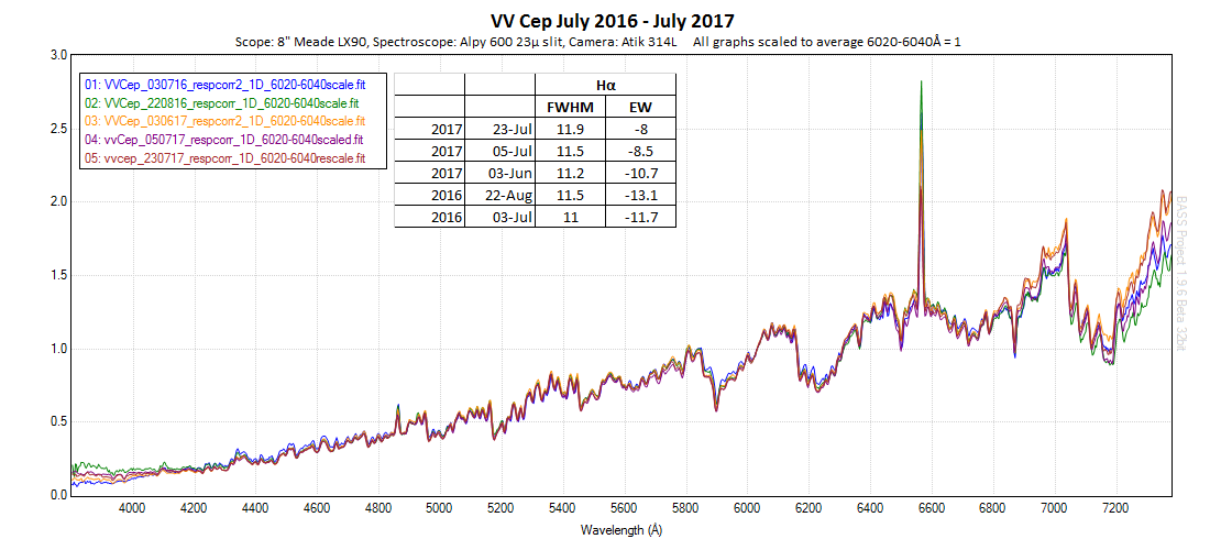

Following advice here I have scaled my spectra so that the average intensity between 6020-6040Å is set to 1 in each case. There is certainly some variation in my response correction, something I'll have to look at. I also developed a reasonably consistent rectification process for estimating the equivalent width and FWHM of the Hα emission. I wouldn't pretend the EW measurements are particularly accurate but there does seem to have been a relative decline since last year. Anyway, monitoring VV Cep is great fun even at low resolution :)
Hugh

Re: VV Cep evolution at low resolution
Hi Hugh,
That's pretty good from ~4100-6800. Dont forget also that as the brightness changes due to pulsation of the cool star, the continuum shape will change naturally in any case to some degree due to the change in temperature of the cool star (and the shape change will be even more during eclipse as the hot star component disappears) The instrument response at far ends where the sensitivity drops off are always the most difficult to get right, particularly at the blue end where the response is dropping off fastest and atmospheric extinction and chromatism in the atmosphere and optics are most pronounced. The key thing is to keep everything as identical as possible between measuring the reference and target spectra, including focus and positioning of the star on the slit. Also when you generate the instrument response using the reference star, first check that it works perfectly on the reference star, which it should of course. If there is any discrepancy between your corrected measured spectrum and the library spectrum, you can go back and try to improve your instrument response calculation.

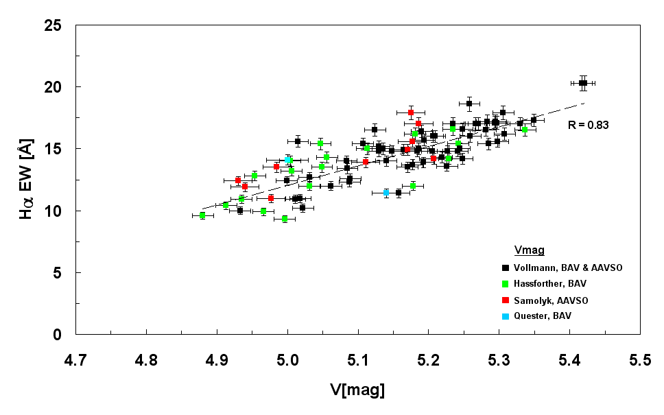

Hi Hugh,
please be careful with the rating of the EW in your spectra. The measured EW in VV Cep depends mainly on two things:
1) of the continuum brightness Vmag under the emission. If Vmag is growing, the EW decreases and vice versa. This is demonstrated in the attached Fig.
The reason is the process of normalization, the division of the non-normalized spectrum through the (varying) pseudo-continuum.
2) on a intrinsic flux variability within certain limitations. The causes of that variability is still unknown so far (discontinuity in mass flow from the M star to the accretion disk ?).
This means for example: as long as Vmag had been unknown during the exposure of your spectra, as long one can not say the EW has changed.
vvcep_EW versus Vmag.png (17.65 KiB) Viewed 22051 times
Ernst

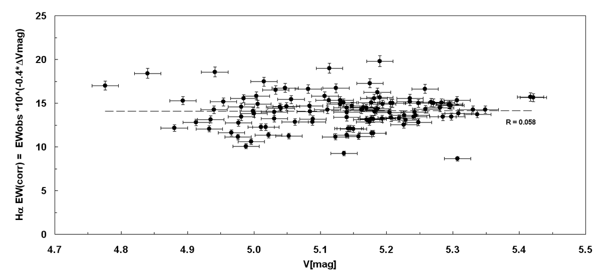

the diagram Halpha EW v. Vmag should demonstrate the quantitative influence of the continuum brightness under the measured emission. Of course it was not the intention, to use this correlation for prediction of the Halpha continuum flux.
In case of VV Cep one have to consider that EW & Vmag must be assigned different physically sources. Vmag represents the physical happenings of and in the M star (among others pulsation), whereas the Halpha emission reflects the recombination of ionized hydrogen gas of the accretion disk.
However, both locations of origin are spatial not resolved of the observer. With other words: Halpha EW & Vmag are physically not correlated to each other. This is clearly to see when Halpha EW is corrected by Vmag (following Fig.).
This is particularly true in the present orbital phase shortly after the apastron, in which the M star and the B star are about 10-15 AU apart.
Therefore it would be wrong, to determine the absolute continuum flux (with Vmag as parameter) under the emission, in order to find out something of the intrinsic Halpha EW variability.

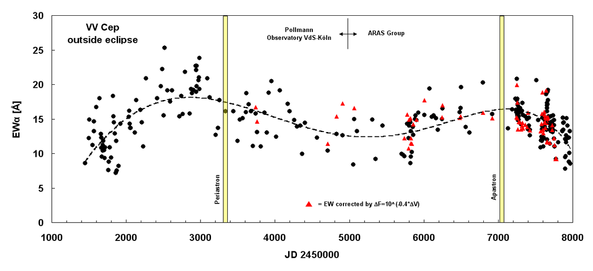

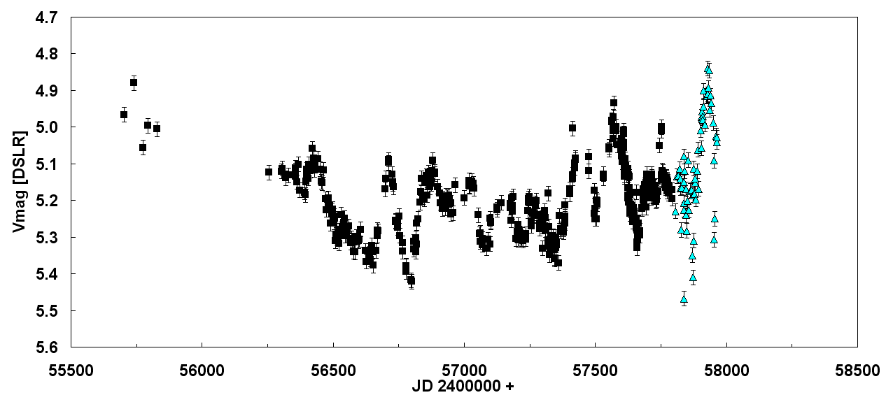

The growing data from observers of the Aras group enables the continously monitoring of the Halpha EW time behavior. This is shown in the following diagram.
Obviously is the dominant long-term variation with a cycle of approx. 4000 days and two maxima of emission activity. Also the Vmag corrected Halpha flux (red triangles) follow this behavior. In that diagram I have marked the time of the last peri-astron and last ap-astron.
Striking here is a higher emission activity clearly far before the peri-astron. If both stars approx. 10-15 AU are away from each other, then a higher emission activity (caused by mass flow/wind of the M star) particularly around the ap-astron seems to be unlogical from my point of view.
On the other hand we have demonstrated in our IBVS paper No. 6156 that the corrected Halpha flux seems to be more or less constant in time. This leads me to the consideration of the causes (at least) of the emission activity around the ap-astron.
What, if we would assume that the B star does have its own disk, beside the accretion disk? We would have in that case a superposition of two objects with emission activity. An accretion emission activity (fed by mass flow/wind from the M star) and additionally an emission activity coming from the (fictive) B star disk. With this scenario and with the individual dynamic of this second disk we could explain:
1) the long-term cycle as one-armed density enhancement in the B star disk,
2) the flux variability with shorter periods as it is described in our IBVS paper,
3) we would have an explanation for the independence of the Halpha flux variation from Vmag.
