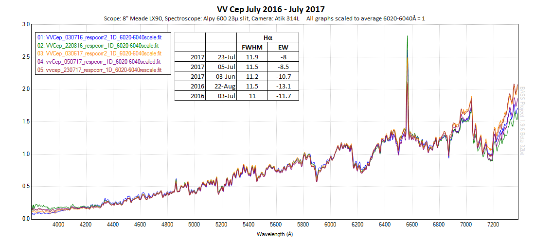

Thanks everyone for some fascinating observations, I have found the conversation very useful.
I am using nu Cep as my calibration star so I think I have the influence of atmospheric extinction under control; nu Cep lies quite close to VV Cep in altitude, and its spectrum is in the Miles database.
Regarding scaling of spectra so that they can most easily be compared I will have a go at Robin's suggestion of presenting the spectra so that they are anchored on the relatively featureless part of the continuum around 6100Å. I am using BASS to process my spectra and I'm still learning about the scaling features - I'll keep you posted how I get on.
I can now better understand some of the uncertainties around measurement of Equivalent Width in my spectra. I'll try to develop a consistent methodology for rectifying the spectra in a narrow region around the H-alpha emission at least to minimise variation due to the way in which I reduce the spectra.
Thanks a lot
Hugh

Following advice here I have scaled my spectra so that the average intensity between 6020-6040Å is set to 1 in each case. There is certainly some variation in my response correction, something I'll have to look at. I also developed a reasonably consistent rectification process for estimating the equivalent width and FWHM of the Hα emission. I wouldn't pretend the EW measurements are particularly accurate but there does seem to have been a relative decline since last year. Anyway, monitoring VV Cep is great fun even at low resolution :)
Hugh

That's pretty good from ~4100-6800. Dont forget also that as the brightness changes due to pulsation of the cool star, the continuum shape will change naturally in any case to some degree due to the change in temperature of the cool star (and the shape change will be even more during eclipse as the hot star component disappears) The instrument response at far ends where the sensitivity drops off are always the most difficult to get right, particularly at the blue end where the response is dropping off fastest and atmospheric extinction and chromatism in the atmosphere and optics are most pronounced. The key thing is to keep everything as identical as possible between measuring the reference and target spectra, including focus and positioning of the star on the slit. Also when you generate the instrument response using the reference star, first check that it works perfectly on the reference star, which it should of course. If there is any discrepancy between your corrected measured spectrum and the library spectrum, you can go back and try to improve your instrument response calculation.

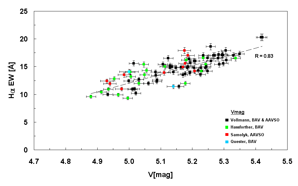

please be careful with the rating of the EW in your spectra. The measured EW in VV Cep depends mainly on two things:
1) of the continuum brightness Vmag under the emission. If Vmag is growing, the EW decreases and vice versa. This is demonstrated in the attached Fig.
The reason is the process of normalization, the division of the non-normalized spectrum through the (varying) pseudo-continuum.
2) on a intrinsic flux variability within certain limitations. The causes of that variability is still unknown so far (discontinuity in mass flow from the M star to the accretion disk ?).
This means for example: as long as Vmag had been unknown during the exposure of your spectra, as long one can not say the EW has changed.
vvcep_EW versus Vmag.png (17.65 KiB) Viewed 22062 times
Ernst

The problems is, EW is not a useful measurement for emission lines as the flux in emission lines is generally independent of the continuum, as you pointed out. To measure the strength of emission lines and how they are changing, you need to calibrate the spectrum in absolute flux. This can be done by absolute calibrating low resolution spectra, for example using V mag values, to give a true value of flux at any wavelength without the need to assume a correlation between continuum flux in the V mag band and in the continuum at the emission line being measured (which is approximate at best and may not be true at all). Here is a very good recent example on the group of how this is done.
http://www.spectro-aras.com/forum/viewt ... t=70#p8931
Note particularly near the end of the animation the way the continuum at H alpha continues to rise while the continuum at 5000A remains constant. This is an example of why you should not try to use V mag to predict H alpha continuum flux.
Who is doing photometry during this campaign Ernst? Do you have V mag values for dates corresponding to Hugh's spectra which we can use to calibrate the spectra in absolute flux?

the diagram Halpha EW v. Vmag should demonstrate the quantitative influence of the continuum brightness under the measured emission. Of course it was not the intention, to use this correlation for prediction of the Halpha continuum flux.
In case of VV Cep one have to consider that EW & Vmag must be assigned different physically sources. Vmag represents the physical happenings of and in the M star (among others pulsation), whereas the Halpha emission reflects the recombination of ionized hydrogen gas of the accretion disk.
However, both locations of origin are spatial not resolved of the observer. With other words: Halpha EW & Vmag are physically not correlated to each other. This is clearly to see when Halpha EW is corrected by Vmag (following Fig.).
This is particularly true in the present orbital phase shortly after the apastron, in which the M star and the B star are about 10-15 AU apart.
Therefore it would be wrong, to determine the absolute continuum flux (with Vmag as parameter) under the emission, in order to find out something of the intrinsic Halpha EW variability.
On the other hand, if one wants to see the eclipse of the B star through the M star in the continuum, then it make sense to calibrate the spectra in absolute flux. I have gathered the photometric Vmag data of the BAV & AAVSO. If you are interested I can make them available.
Ernst
