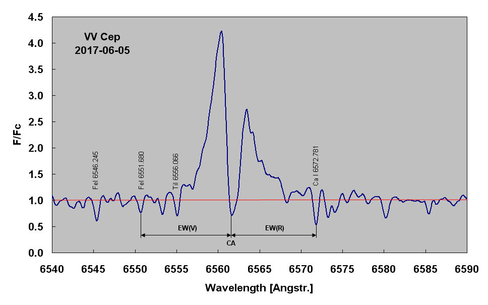

But first, I wanted to get information of the pseudo-continuum. That´s why I compared your (170927) spectrum with a flux-calibrated ones of the MILES data base (No. s0199, HD039801, spectral type M2Iab).
This comparison shows a well agreement in relative flux within the Halpha range. It seems there is no appreciable influence of instrumental response in that area. But of course, for EW evaluation it requires the process of normalization.
EW determinations have been carried out since 1996 always within the spectral section 6551 to 6573 A. To execute that, a normalization has been carried out always within the section 6540 to 6590, how it is to see in the Figure above. You will recognize that a certain (minimum) of spectral resolution is necessary to determine plausible values of EW.

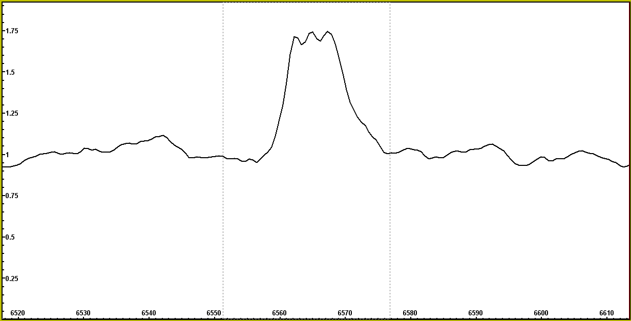

I have zoomed the mentioned spectral range for normalization and EW determination as it is to see in the Figure above, in order to show, how this process has to be carried out in your low-resoluted spectra. The EW in your spectrum is - 7.5 A, but it should be -9.8 A compared with the value of the campaign monitoring.
In addition you can see that the Halpha emission shows a strange and unrealistic profile which is based in the too low spectral resolution. With other words: seriously EW determinations in such a sort of spectra are less to not meaningful.

it happened that I sent our worst spectrum. We had an issue with our spectrograph, it failed to focus the whole spectrum at once. So it was replaced with a new one. The following spectra should be of much better quality. I know your time is limited, still it would be so kind of you if you looked at one of the other two spectra.

yes I saw your other spectra, but I used the one of 170927 because it has the best signal/noise.
For EW evaluation I used VSpec and its EW computation, but I don´t know which integration method is implemented there (rectangle/tangent/trapezoidal/Simpson rule ?). Perhaps Valerie could give an information.
Thank you very much for the offer to make the other spectra available, but for the current Halpha campaign we don´t consider spectra with such a low resolution. Hope you will understand that.

Andrew,
in this case I used a smoothed spline function in VSpec after supress of the Halpha profil.
Ernst
