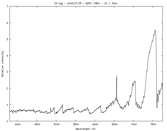

Please find my contribution to this topic with a low resolution spectrum taken during the last OHP workshop.
20x30s with Alpy600 spectrograph on 250 mm F/4 Newtonian telescope.
Vincent
Re: CH Cyg 2018
Posted: Thu Jul 26, 2018 7:50 am
by Vincent Bouttard
Hello
CH Cyg last night. 20 x 30s with Alpy600 on 250 F/4 Newtonian telescope (I've made a mistake on the title of this image about the exposure time).

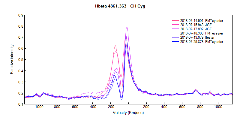

Re: CH Cyg 2018
Posted: Thu Jul 26, 2018 5:14 pm
CH Cyg returns to its previous luminosity
Last Echelle spectra:
http://www.astrosurf.com/aras/Aras_Data ... /CHCyg.htm
Of course, we undergo high cadency monitoring until the return to previous state

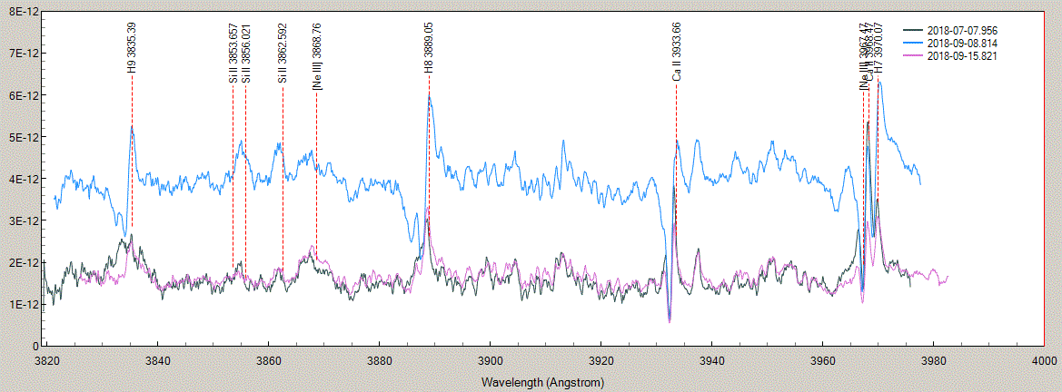

Re: CH Cyg 2018
Posted: Thu Jul 26, 2018 7:14 pm
by Peter Somogyi
Hello Francois,
I think the H-beta is considerably affected by the B component's flux level - hence can be mixed by a similar absorption that's prominent clearly in the UV:
The green line is my new observation, unfortunately got bad weather here and can't shoot for 1-2 weeks.
What I suspect, the jet in the line of sight is precessing towards the 0 km/s vrad (maybe approached it by now).
I'd rather recommend looking at the sudden EW(H-alpha) drop happening since 07.12 - that's what the daily spectra show in the database, just cannot graph so many data.

Re: CH Cyg 2018
Posted: Sun Sep 16, 2018 12:20 pm
by Peter Somogyi
CH Cyg went into a blue minima again (see aavso).
By fortune with yesterday session, I've got 2 spectra close by 1 week showing high & low state having their own flux (using the wide slit, ref.: Vega/calspec):
Included my spectrum on 2018.07.07 which was in the middle of the earlier minima.
I am curious what is causing these events.
