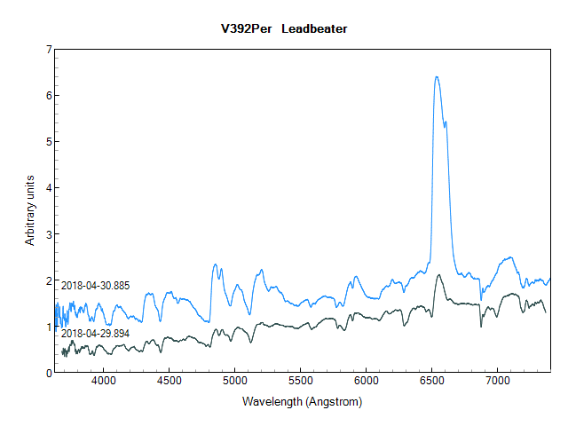

The continuum in the spectrum posted in the ATel is much flatter than mine, though the features are identical. It was quite low at the time (~30deg), though the reference star was at a similar altitude so the extinction correction should have been roughly ok. It will be interesting to see followup spectra.
The comparison with sn2017eaw is interesting. I thought the width of the lines was greater than I had seen before for novae and even ran the spectrum though GELATO just in case, though without a decent match. Is the brightness increase (~11 magnitudes) and velocity ~2600km/s higher than typical for a nova?

Tonight's spectrum compared with last night

Many thanks for sharing your observations. Fascinating to see such even almost in real time ! Impressive change compared to yesterday... The dynamic is much faster than the SN2017eaw example I was using to facilitate line identification. Hope I will have better weather condition tonight to try a contribution.

This a a fast nova with fasr decline and evolution of the broad emission lines
Fast novae with broad lines derive from *massive* white dwarf in binary systems: the thermonuclear runaway is stronger and only a little part of the accreting layer is ejected at high speed (> 2000 km/s)
Of course, nothing to do with a supernova event.

I see from the AAVSO alert
https://www.aavso.org/aavso-alert-notice-633
that there is a published spectrum taken a few hours before my first one
https://www.nayoro-obs.jp/pirka/nacs/V3 ... 180429.png
There were already big changes between this spectrum and mine.

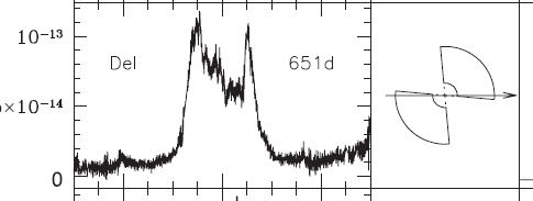

Les raies Ha et Hb me semblent à 2 pics, est ce cela ? Un coté qui vient un autre qui part ? Peut on mesurer quelque chose avec ces doubles pics ?

Le double pic, bien visible en basse résolution montre que l'ejecta est sans doute constitué de deux parties, l'une en expension vers nous (bleu) et l'autre s'éloignant (rouge)
Quelque chose comme:
A partir du spectre, on peut mesurer la vitesse d'expension
L'idéal est de mesurer la largeur à la base (FWHI) et de la diviser par deux. Pas facile de déterminer précisément où s'arrête la raie
Une bonne mesure est FWHI à 10% de hauteur
A partir d'un spectre obtenu par Jim Edlin, on trouve 7200 km/s soit une vitesse d'expension de 3600 km/s
La vitesse maximale, estimé à la base pourrait être 4200 km/s
