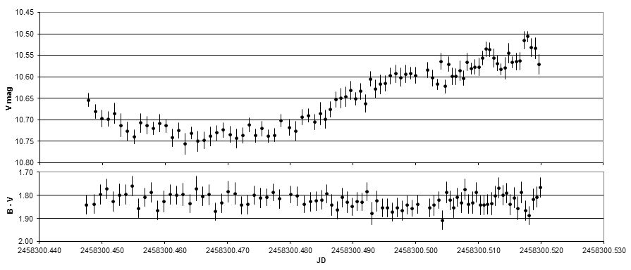

by David Boyd
The following transformed B and V band photometry of Nova Sct 2018 was recorded with a 0.35m SCT between 22.44 and 00.29 UT on 30 June/1 July.
Nova Sct 2018 photometry 30Jun2018.png (14.61 KiB) Viewed 32037 times
Spectra were taken concurrently with a C11 + LISA between 23.25 UT and 00.25 UT. R=1064. A mean V mag of 10.63 was adopted to flux calibrate the spectrum. As the average altitude of the nova was only 22 deg, atmospheric correction may be suspect.
