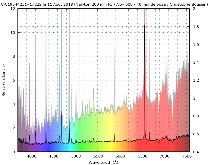

Post by Christophe Boussin »
Bonjour à tous,
Merci pour ces informations François !
Voici ma contribution au suivi de TCPJ19544251+17222 obtenu ce 11 Août à 21 h 57 TU avec une résolution de 502 (JJ = 2458342.4374) et une durée d'acquisition de 40 min (8 x 300 s).
TCPJ19544251+17222 le 11 Août 2018
_tcpj19544251+17222_20180811_915_Christophe Boussin_3700_7570.png (100.01 KiB) Viewed 36569 times
Spectroscopicalement,

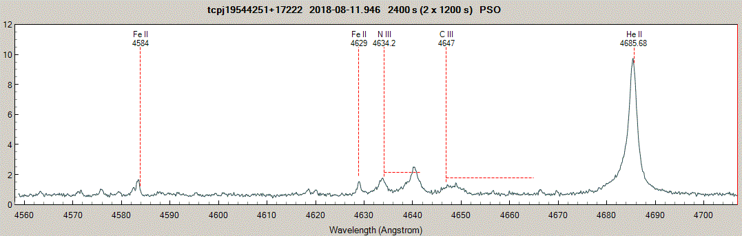

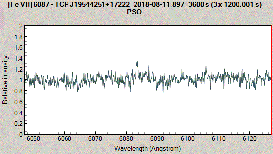

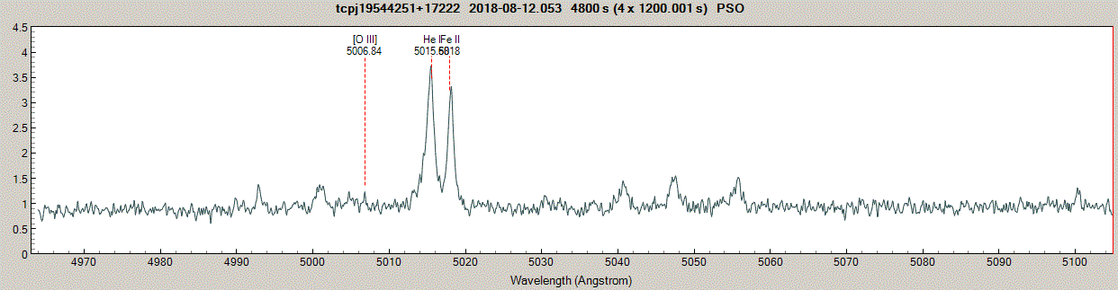

Re: ASASSN-V J195442.95+172212.6 10.7V mag in Sge
Fresh results from yesterday with 300/1200 Newton + 2.67x APM Barlow + LHires 2400/mm, 35 micron slit, ATIK 428 EXm (2/3" chip size), provides R~9400 local resolution in the blue and R~1300 at 6000A.
The [FeVII 6087] seems to be nonexistent, a tiny feature at 6083A detectable but clearly away:
The [OIII 5007] is also nonexistent:
The best region for an LHires with the 2400mm grating looks to be NIII/CIII:
Sent spectra to database, including also a Hb + He I 4622 region that seem to already match well with Olivier's eShel spectrum above.

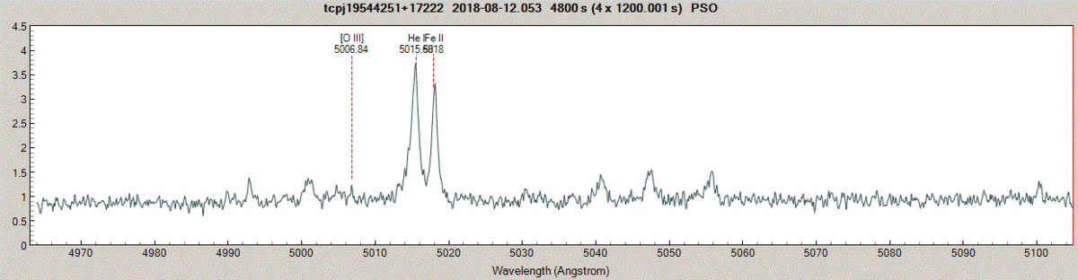

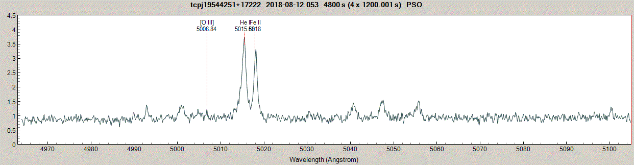

Hi Peter, all,
yesterday I also observed the symbiotic with Lhires III and 600 l/mm grating.
The detail around He I 5016 (unresolved pair with Fe II 5018) seems a little different than your. The signal is poor but feel like there is something near the oxygen line wavelength. To be explored...
