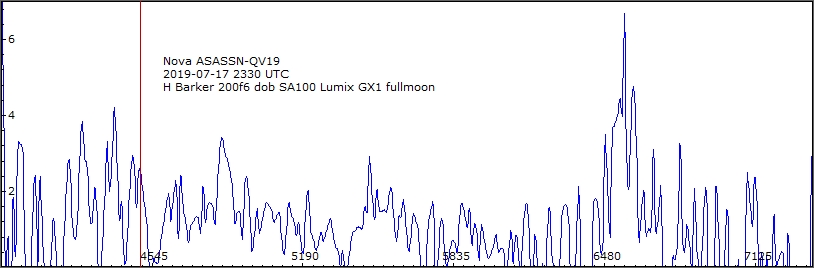

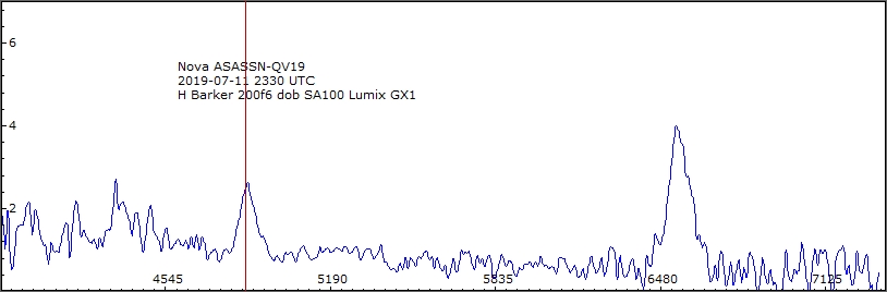

New spectrum from last night. Had some issues with moonlight, mount and drive rate, and possibly haze, as the sub exposures seem a bit dimmer.
I think the calibration from my previous one was incorrect due to an automatic function in ISIS.
Does any know if there is a section on Bess database for nova spectra? (when I get my data quality sufficiently improved).
(updated the spectrum as it had a completely incorrect calibration)

JJ Broussat
- Posts: 70
- Joined: Fri Aug 17, 2012 2:59 pm
Re: ASASSN-19qv: classical nova (11 mag) in the SMC
Bess Database is only for Be type stars, not nova.
Best regards
Jean-Jacques Broussat
Best regards

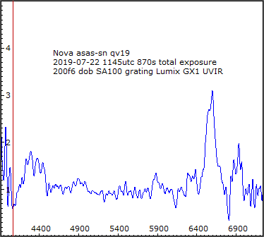

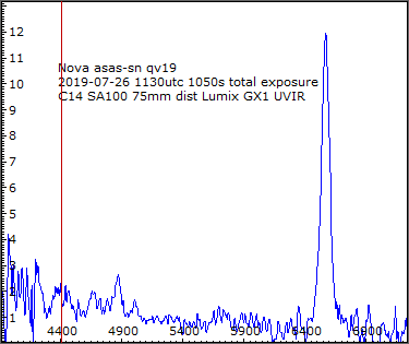

I got clear weather on three more dates (and clouds rolling in after 1 or two subs on another!).
22 Jul seems to be much less Hbeta, mainly Halpha
26 jul I used the club C14, but at the same dispersion as the other spectra. So it should be lower resolution due to the much longer focal length. But my other data were pretty poor images so maybe the better tracking of the c14 is giving better resolution anyway.
On 26 jul, the Halpha peak intensity is 3x what it was previously! I double checked that it wasn't a star accidentally sitting in the field of the slitless spectra, but it really is the star.
- 2019-07-26-qv19-c14.png (8.52 KiB) Viewed 11555 times
- nova-asassn-qv19-2019-07-22-1145utc-870s.png (7.71 KiB) Viewed 11555 times

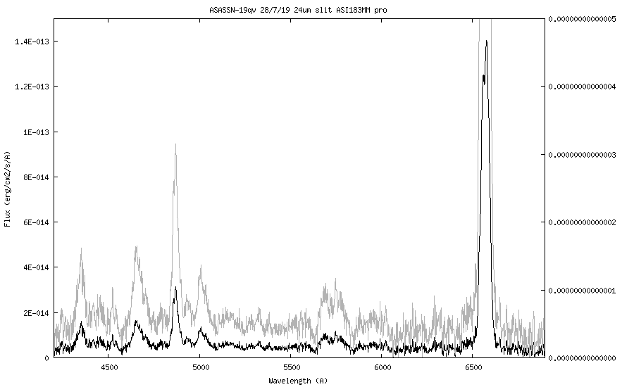

Terry Bohlsen
- Posts: 191
Hi All
Sorry I'm slow replying Hamish. Well done!

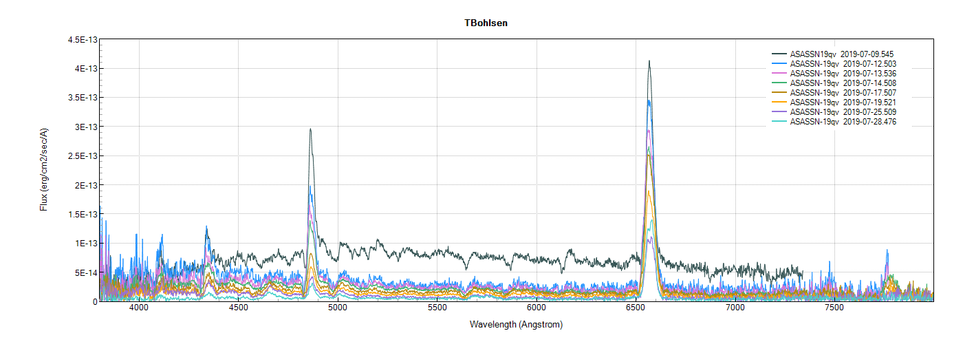

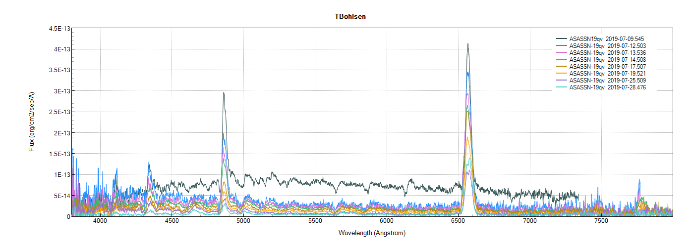

I have taken multiple spectra of this nova. It is getting pretty dim now at mag V=14.5
I don't think flux calibration would be easy with a SA200. I am using a slit spectrograph (LISA) and I can flux calibrate because I take simultaneous photometry through a V filter.
There has now been 2 telegrams thanks to Steve Shore!
Terry
Terry
A nice set of spectra Terry!
Absolute flux calibration using the Star Analyser is an interesting subject. If you have a reference star in the same field you can do the spectroscopic equivalent of differential photometry and because it is slitless you don't need to worry about loss of flux at the slit. It is not straightforward (flat fielding in particular) and a rather niche technique but it can be useful for studying fast transients.
http://www.threehillsobservatory.co.uk/ ... tra_42.htm
For the BAAVSS/AAVSO meeting last year I took the results from that run and generated B and V mag data for comparison with conventional photometry. See the attached slides extracted from the full presentation (zipped pdf)
