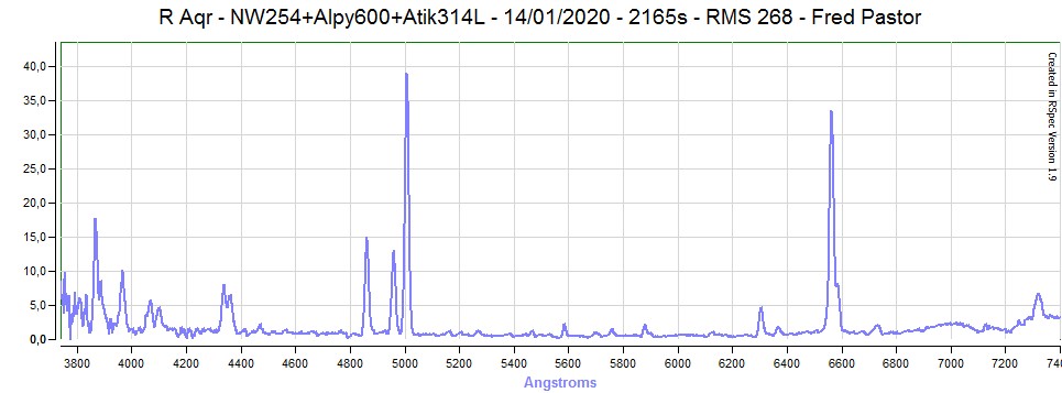

Here is my contribution of R Aqr taken last week. I confirm, star rather low on the horizon after the sunset. And less than one hour of exposure before the star disappears behind the mountain ridge (from my site):
R Aqr taken the 14th of Jan
R Aqr FP 14 01 2020.jpg (68.21 KiB) Viewed 19883 times

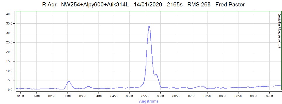

Despite my low resolution, we may find a little difference on the H-alpha emission showing the slight bifurcation mentionned previously by James:

Re: R Aqr Eclipse - Monitoring requested
Posted: Sun Jan 26, 2020 10:39 am
James :
The shape of H alpha line strongly depends of the conditions of acquisition, notably the orientation of the slit, position of the target against the slit ...
See the work of Paolo Berardi in
http://www.astrosurf.com/aras/novae/Inf ... 017-07.pdf
(pages 71-75)
Frédéric:
What you observe in the red part of H alpha is the forbidden line [NII] 6584, blended with Ha.
The resolving power is far to be able to resolve H alpha line in R Aqr
BTW: I think that the resolution of your Alpy could be significantly improved. I would suggest: work "on the table" and try tuning the internal focus of the spectroscope on Ne/Ar spectrum.
In ISIS, you can load an image of the Neon (1. Image) and use "Line PSF" to get the FWHM of a line. I suggest the bright neon line at about 5400 angstroms. Tune the internal focus in order to get the lowest FWHM value as possible.
Bonne continuation,

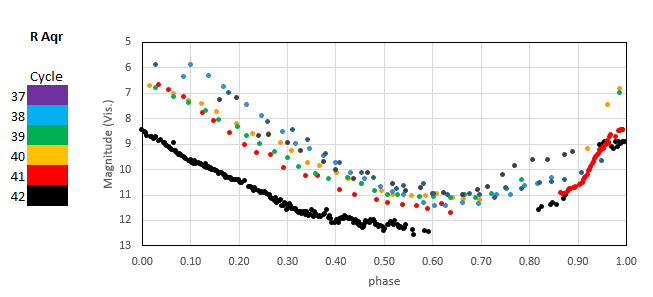

Posted: Wed Jul 08, 2020 4:43 pm
New season and new pulsation cycle for R Aqr.
The Mira is now at its brightest luminosity at phase 0.0
The maximum is still very low, even lower than during the previous pulsation.
We note the very similar rises of the two last pulsations.

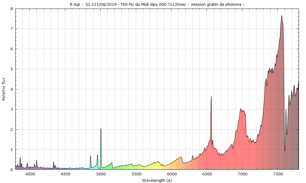

R Aqr as seen 2019 - 08 - 31, for what it is worth

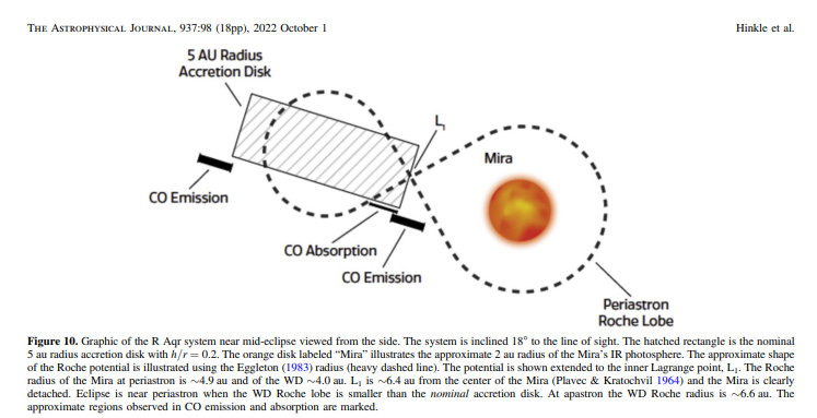

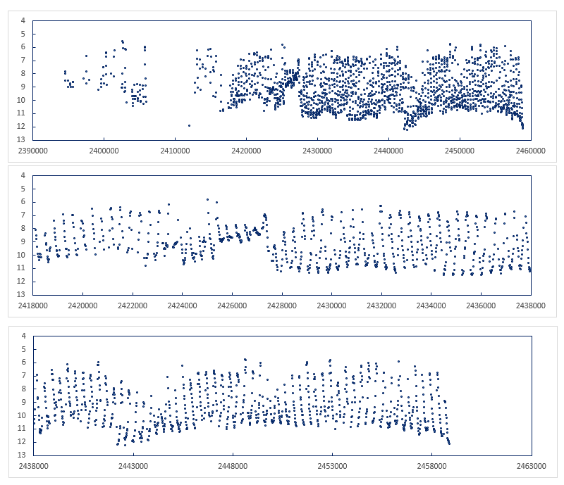

An informative publication about R Aqr eclispe that we observed in visible:
https://iopscience.iop.org/article/10.3 ... ac8a47/pdf
A model from IR observations:
Ungoing observations are welcome!
https://aras-database.github.io/database/raqr.html
