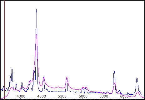

Robin Leadbeater wrote:
The resulting spectra look well calibrated
for example here is your WR136 spectrum compared with Christian's spectrum using a LISA from
http://www.astrosurf.com/buil/survey/wr ... html#WR136

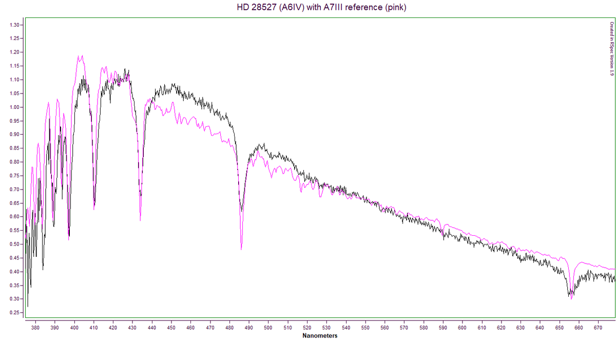

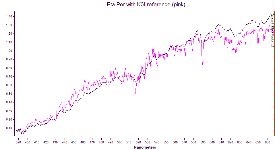

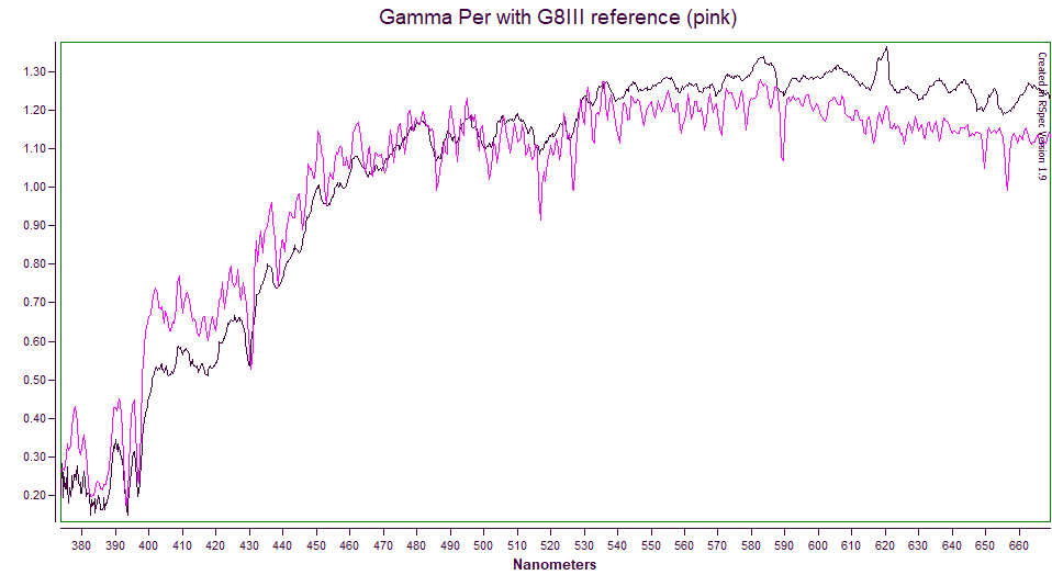

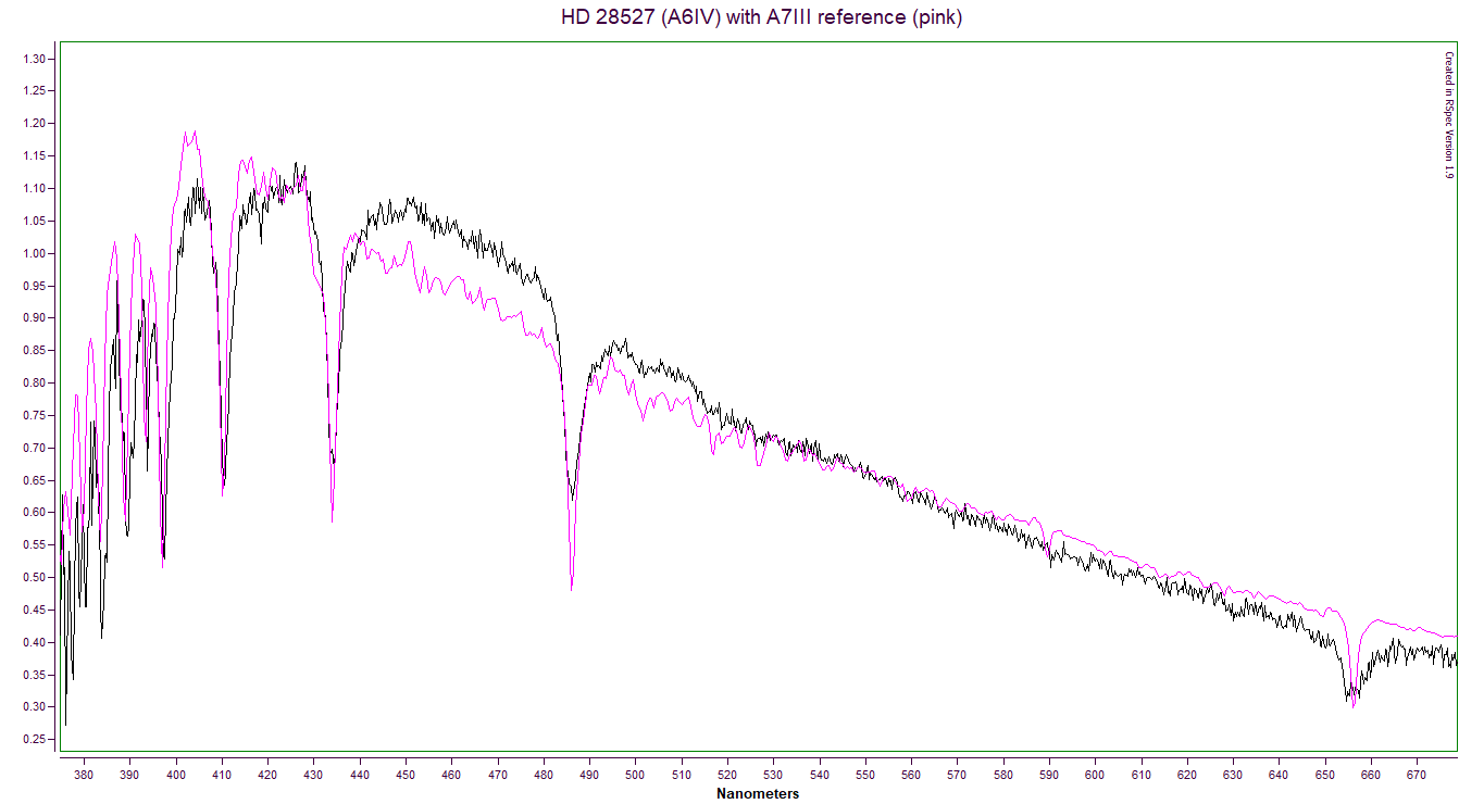

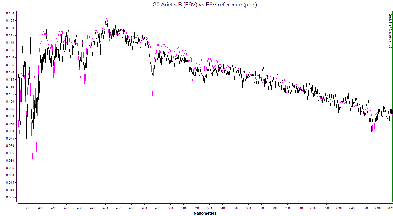

James Ley
Posts: 70
Re: Staranalyzer et polynôme...
Post by James Ley »
etienne bertrand wrote:Ce que je fais quand je ne connais pas les raies du spectre de l'étoile, je cherche son type spectral et je charge le spectre de référence du type spectral de l'étoile et je calibre sur les raies mesurées avec le spectres de référence...
Voici la constellation de Cassiopée
Bertrand.This is crazy! :o Why are you even taking the spectra if you already need to know what it is ?? This is science, not like astrophotography where people try to make their image look like the one in the book ;)
Ignore the advice not to use the zero order. The zero order is the only common reference point you have. Use it with the linear dispersion and your calibration will be close enough.
I think there are some good reasons to not use the zero order. I can achieve far higher resolution with my small CMOS camera (ASI290MM).
The common reference is, in fact, the dispersion, which doesn’t change. I begin by building a polynomial using the Balmer lines from an A-type star.
Then I add in the Ca II K and H lines and Na I D line from an F- type star
At this point I have a polynomial function for the dispersion, which is the same for all stars. I calibrate an unknown star using one point: H-beta for stars O-A, Ca I K for F-type stars and Na I D for K-type and G-type. I don’t need to know the spectral type of the unknown star, I have never had a problem with trial and error.

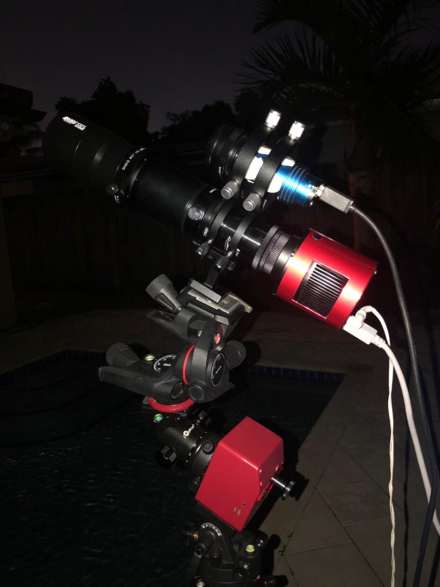

All these spectra were taken with a simple easy to use system: Borg 55mm on a camera tracker. No guiding. 5-10s exposures acquired with ASI290MM-Cool and stacked.
