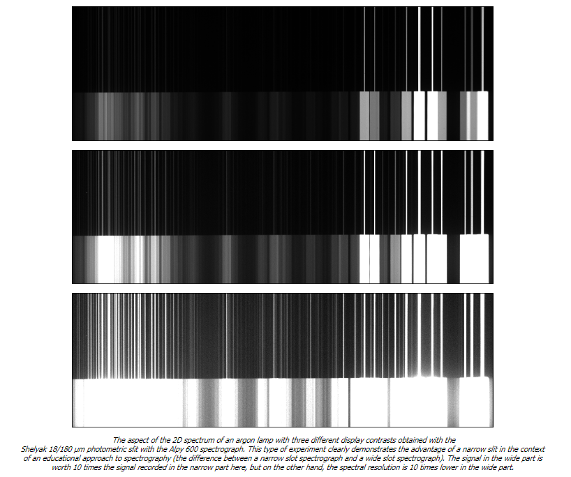

Hi David,
But the area of the approximately uniform field sampled by the slit increases doesn't it ? In which case I would expect the intensity per pixel column to remain constant and the total intensity in each line to increase approximately proportional to the slit width. See the ALPY lamp spectrum with the very wide photometric slit half way down the page for example
http://www.astrosurf.com/buil/alpy600/p ... c_slit.htm

Hi Robin,
Yes, of course you are right with a uniform source of illumination. The two slits should diffract into gaussian-like peaks whose area will scale with the slit width and should have the same height. I was thinking in terms of a point source diffracting into a wider but shallower peak. However that doesn't explain why Pete was seeing fainter lines with a wider slit. Possibly a focusing issue?
