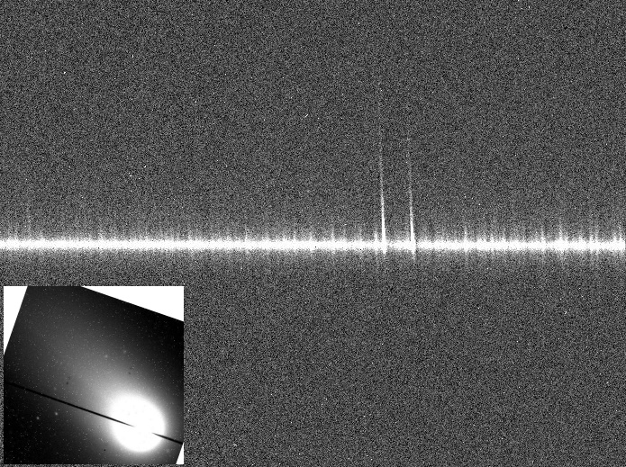

Posted: Sat Aug 01, 2020 10:25 am
Hi Daniel,
Sorry I was not criticising you. It was a general comment asking observers to say exactly where in the comet the spectrum was taken.
The difference between high and low resolution is interesting. High resolution for example shows that the Na D lines were still present even when they were not visible (or very faint) in low resolution spectra. Here is a sky subtracted spectrum image through the coma and tail from 2020-07-20. it clearly shows the Na D lines still there, extending into the tail. (click the full size image to see the position of the slit)
The spectrum also changes across the coma with Sodium close to the centre but the dust and C2, CN emission extending further out, for example
http://www.spectro-aras.com/forum/viewt ... f=6&t=2581
To me these differences are very interesting and not studied by most amateurs who only take spectra of the centre of the coma
