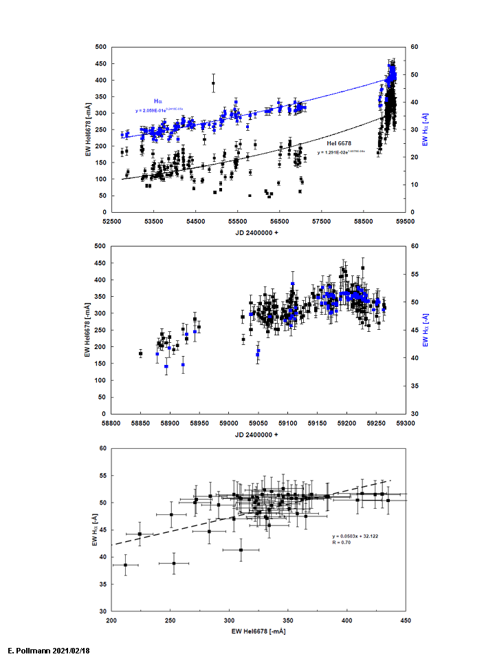

Dear colleagues,
the attached overview informs about the relationship between the Halpha and HeI6678 emission activities of gamma Cas.
As you can see, the EW of Halpha and HeI6678 are correlated in long-term view (upper Fig.) and short-term view (middle Fig.).
The lower Fig. , were only contemporaneous EW data of Halpha and HeI6768 had been used, underlines the character of the correlation particularly clear.
The short-term view (middle Fig.) shows a kind of outburst after JD 2459000, which had been also monitored of our professional colleagues Myron Smith and Gregor Rauw with the X-ray (XMM) satellite telescope.
Thank you very much to A. Stiewing, U. Zurmühl, E. Bryssinck, P. Somoguy, K. Alich, D. Doctor & J. Martin for your usefull spectra contribution after JD 2458800 to this project.
- correlation overview.png (110.38 KiB) Viewed 45760 times

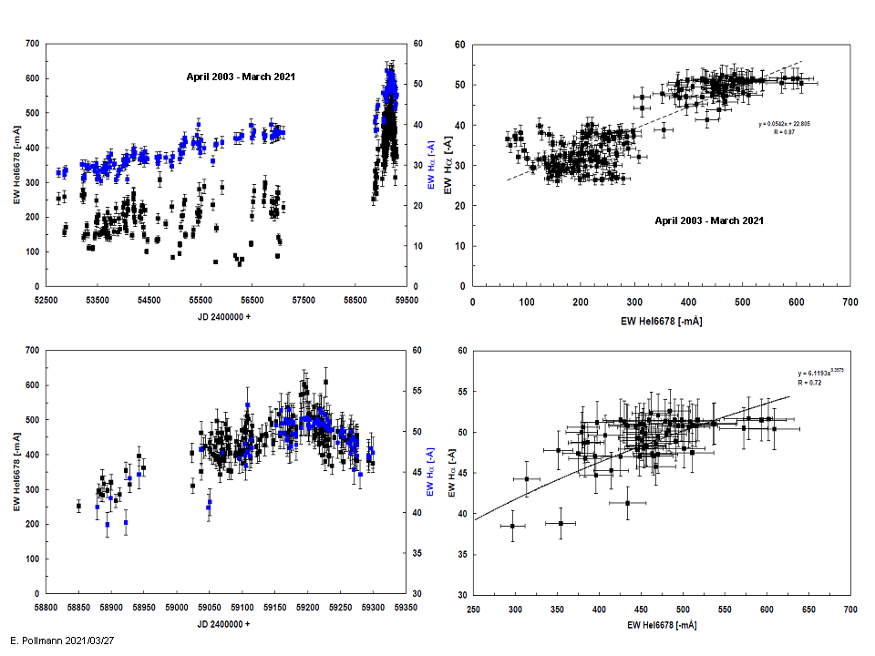

Dear colleagues,
for information and supplement here the current state of the correlation monitoring.
Questions?
- total overview.png (131.63 KiB) Viewed 45400 times

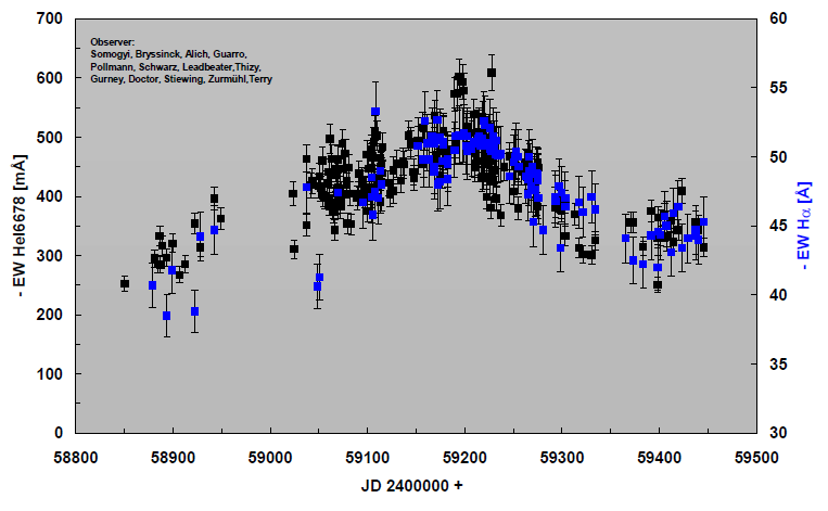

by Ernst Pollmann
Some news:
XMM and TIGRE observations were started on July 25th (G. Rauw, M. Smith, Y. Naze). The professional colleagues are currently working on this data together with our observations (spectra).
In the sense of our further observations, here the current status of the primary spectra evaluation of the EW of Halpha and HeI6678.
Since the beginning of the amateur observations in April 1994, such a cyclical behavior of the two EW (see the attached plot) has not yet been observed.
- monitoring.png (30.24 KiB) Viewed 42742 times
We can be curious to see what conclusions the XMM and TIGRE observations will lead to.
