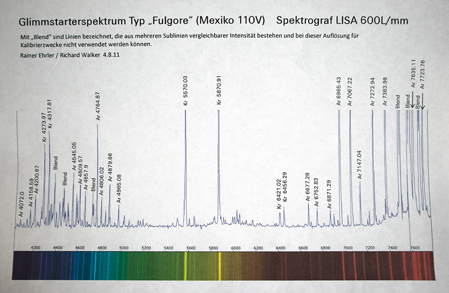

Hi Robin,
Thsnk. Will do. BTW I have now a starter lamp integrated in the telescope cover and with this I can shoot calibration frames in every position. The same lamp was calibrated many years ago by Richard Walker when in some forum there was a opinion exchange about this starter lamps. In Europe the brand OSRAM but I do not get them here. My starter lamp has Argon and Krypton gas.
regards Rainer

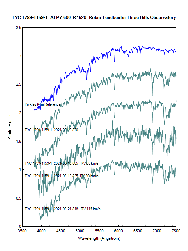

Posted: Fri Mar 26, 2021 2:06 am
Hi Ulrich
Here are four spectra covering 20210316-20210321 compared with Pickles K4iii as a reference. (open the image in a new tab to see it in correct scale)
There are Radial Velocities for three of the spectra, measured by cross correlation with spectra of iota Aur recorded the same nights. I do not have enough data to measure the uncertainty in RV but I would guess it to be ~20km/s 1 sigma so the differences between the nights may not be significant. The spectra can be accessed from the BAA spectroscopy database
https://britastro.org/specdb/
It is too low for me now and will not be visible for me again until August I am afraid
Re: urgent observation request for TYC1799 1159 1
Posted: Sat Mar 27, 2021 5:58 pm
by Ulrich Bastian
Thanks a lot to Rainer Ehlert and to Robin Leadbeater for additional data. They nicely confirm what we think to know about the star (spectral type, luminosity class, rough metallicity from the other spectra, and absolute magnitude from Gaia parallax). This is reassuring. Robin's RVs may be inconclusive at the moment, but let's wait and see what else comes in. I am fully aware how difficult it is to get good RV calibrations (i.e. better than 0.01 percent wavelength calibrations).
