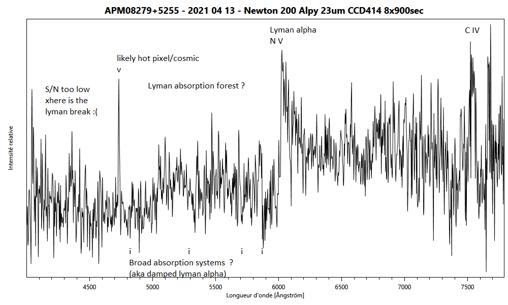

We have good weather in Southern France, I recorded a spectrum of APM 08279+5255 last night to examine the broad absorption features.

Here is the classic lensed broad absorption quasar APM 08279+5255 yesterday night with a standard Alpy and T200 Newton near downtown Toulouse
With a quick reduction in Demetra (could optimize in Isis ?), the spectrum is too noisy to clearly see broad absorption systems in the lyman forest. Nor the lyman break.

The Lyman break is clearly visible on your spectra of the quasars at z 4.4 and 4.5. Again, very nice & impressive results Robin !
