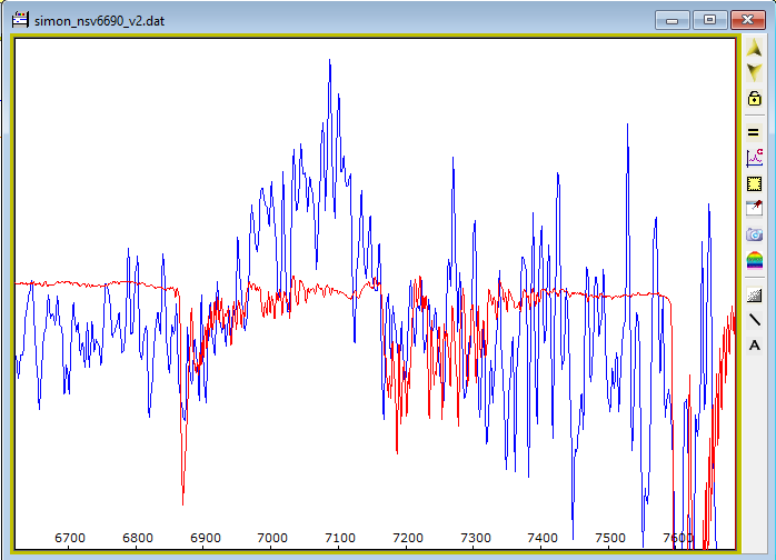

I (approximatively) annotated the spectrum without the redshift correction. The instrumental response is based on a A8V star.
The red line is a smoothed version of the blue curve. Things seems to be quite aligned with Robin's data.

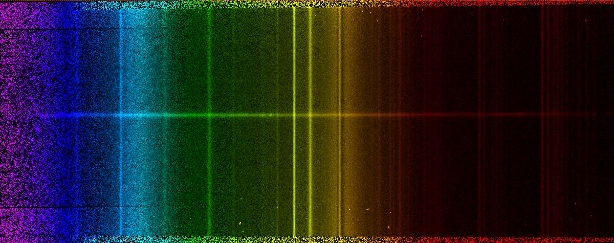

This is the spectrum without the background removal: the telluric lines do appear very clearly (do not mind the colors, that is just to make the image looking good :D) thanks to the skyglow which was apparently quite strong that night.

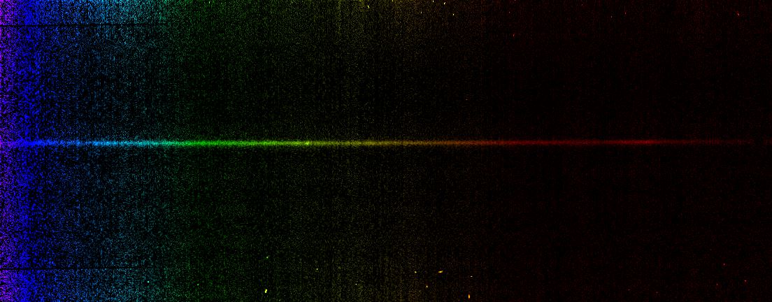

And this is with the background removed:
So I *suspect* that the telluric lines are efficiently removed because of this*.

Here are the telluric bands (in red) superimposed on your spectrum. You can see the holes produced by the absorption bands
(from Christian Buil's Vega atlas http://www.astrosurf.com/buil/us/vatlas/vatlas.htm )
The recommendation for the BeSS and most other databases is to leave them in and let the end user remove them but they are not always obvious and in this case will affect the result.

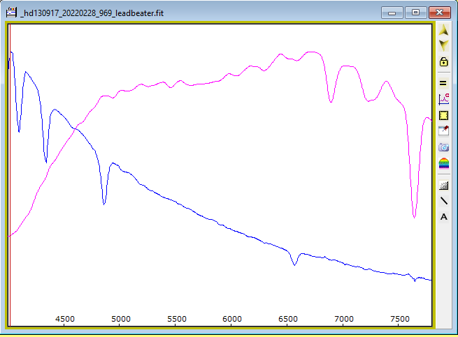

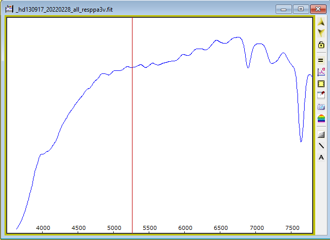

The traditional way to remove them is to make a template from your hot reference star and divide the spectrum by it. In my case I just included them in the response curve. Here is the response I used with the ALPY200 for example. You can see the Telluric bands left in.

Yes including them in the response is only an approximation, you have to use minimum smoothing (It is better than nothing though) It works reasonably well for my very low resolution ALPY200 where the lines blend into bands but is less accurate at higher resolution.

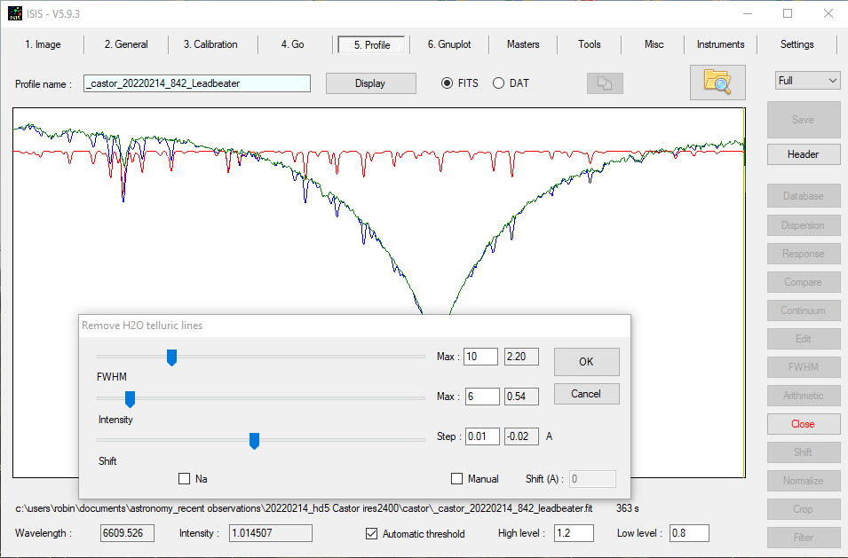

You can also use a pre-prepared template like the one I showed for Vega and "tune" it (scale and filter) to match the tellurics in the target spectrum and then divide the spectrum by it. This only really works well though if the tellurics are obvious, for example In high resolution high SNR spectra. It works well for H alpha profiles of Be stars for example and ISIS has a special function for this. Here it is used on Castor
