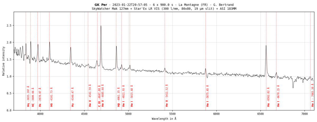

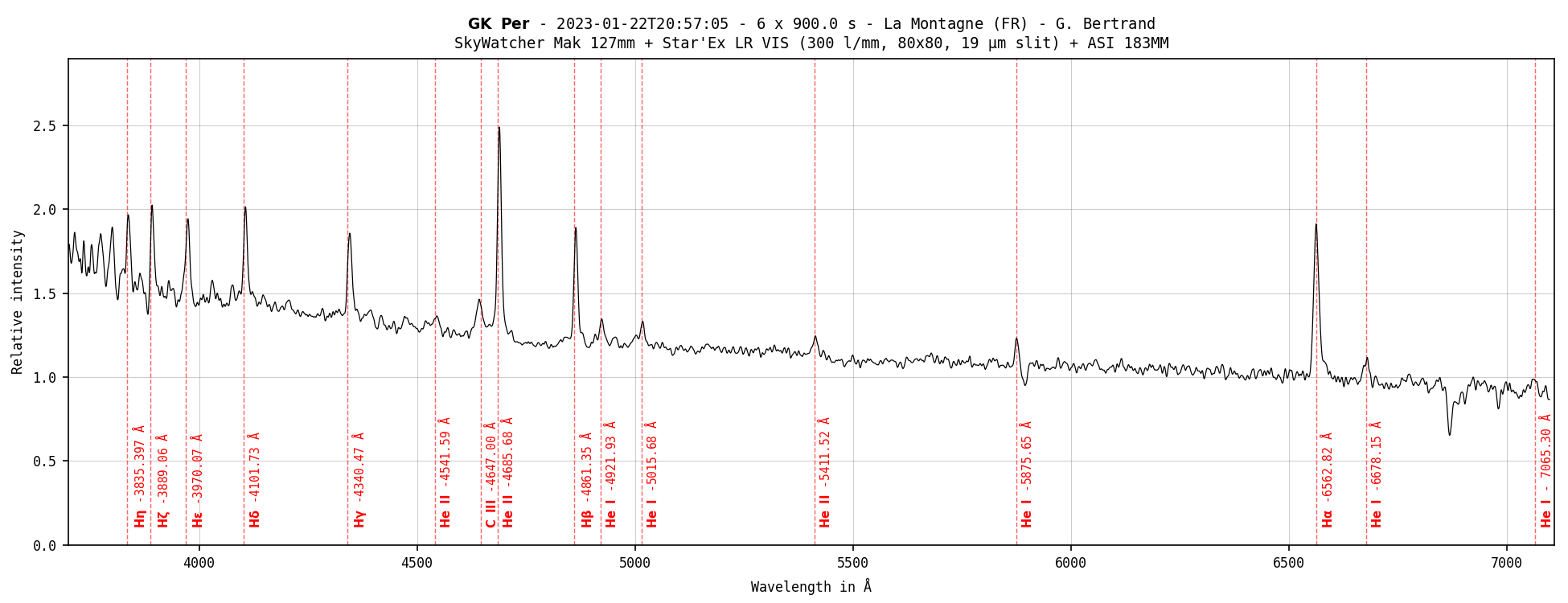

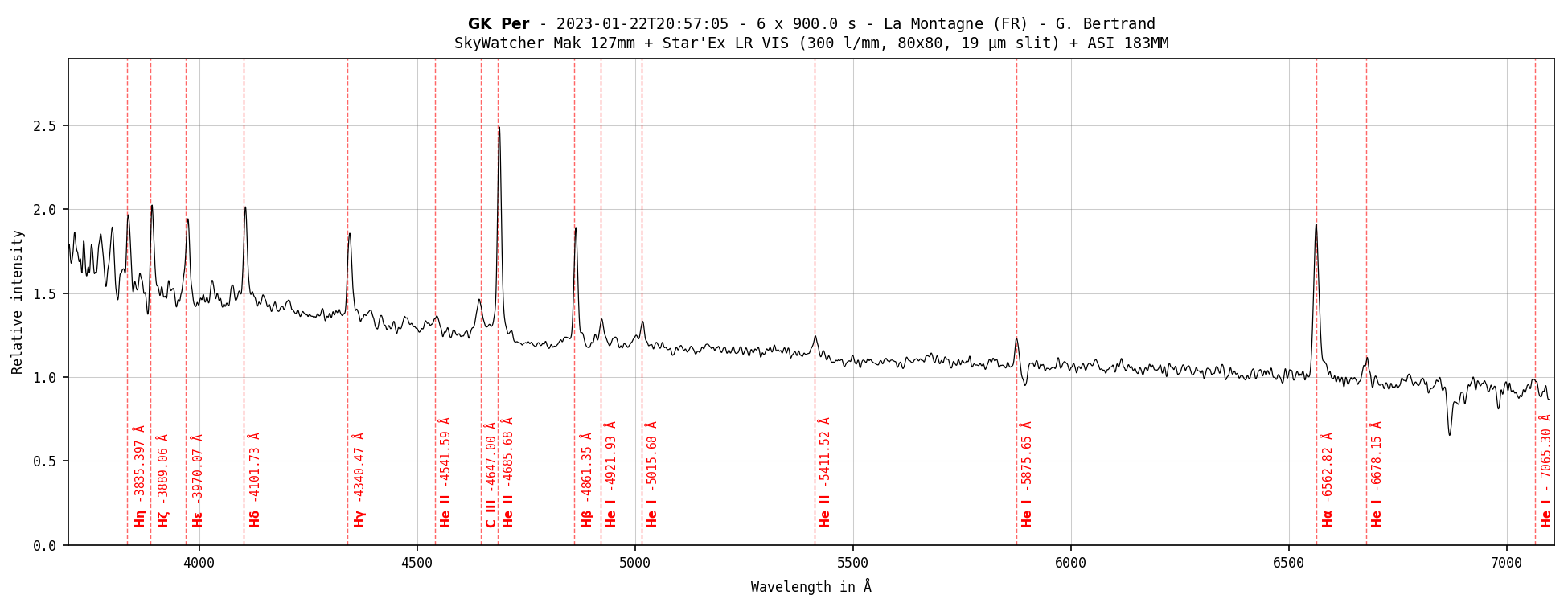

The following spectrum of GK Per was obtained on 22 January at 20:57 UT.
Star'Ex LR (300l/mm, 80x80, 19microns slit) + Mak127
Last edited by Guillaume Bertrand on Thu Jan 26, 2023 5:38 pm, edited 2 times in total.
Posts: 173
Re: GK Per Outburst
Post by Christophe Boussin »
Hi Guillaume,
Happy to see a GK Per spectrum from a skilled Star'ex user ;) !
Do you schedule to do frequent observations of GK Per and send your spectra for inclusion in the Aras database ?

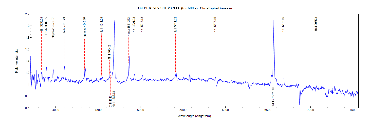

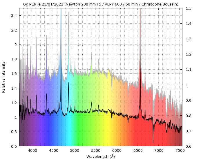

Again, clear skies for a few hours on Monday evening, just enough time to take a second spectrum of GK Per...which was obtained on 23 January at 22:23 UT (resolution of 528, JJ = 2459968.4328) with my Alpy 600 and an acquisition time of 60 min (6 x 600s) :
GK Per on January 23th, 2023
_gkper_20230123_933_Christophe Boussin_3700_7565.png (104.61 KiB) Viewed 33044 times
GK Per on January 23th, 2023 (identification of some lines from PlotSpectra)
Clear skies for all...as often as possible !!

Hi Christophe,
I don't have much time available and the weather is really bad right now :cry:
However, I will try to do some more GK Per spectra in February !
And yes, I sent my spectra to the aras database :D
Clear skies
G

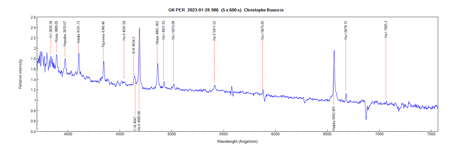

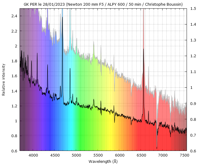

The following spectrum was obtained on 28 January at 23:39 UT (resolution of 527, JJ = 2459973.4857) with my Alpy 600 and an acquisition time of 50 min (5 x 600s) :
GK Per on January 28th, 2023
_gkper_20230128_986_Christophe Boussin_3700_7565.png (110.47 KiB) Viewed 32861 times
GK Per on January 28th, 2023 (identification of some lines from PlotSpectra)
And now I'm waiting for the next clear night ;) !!
Clear skies to all !!

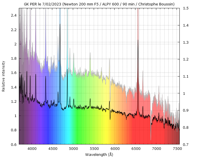

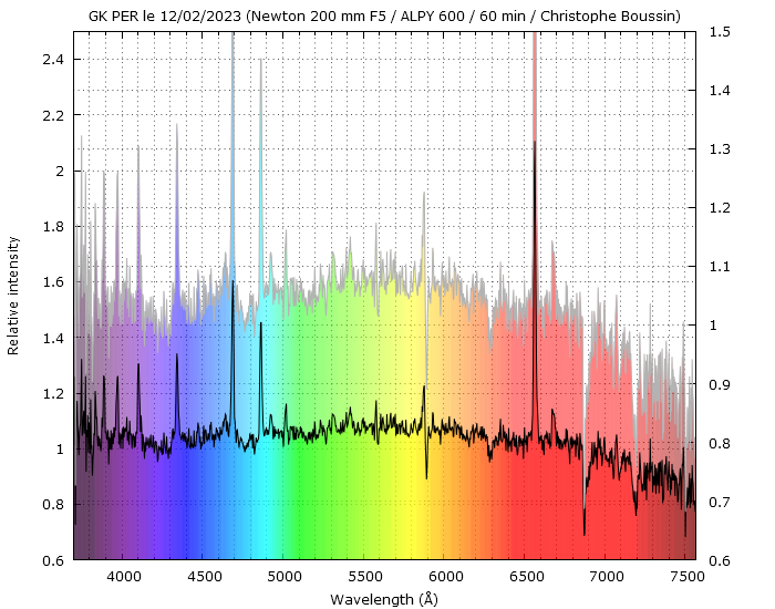

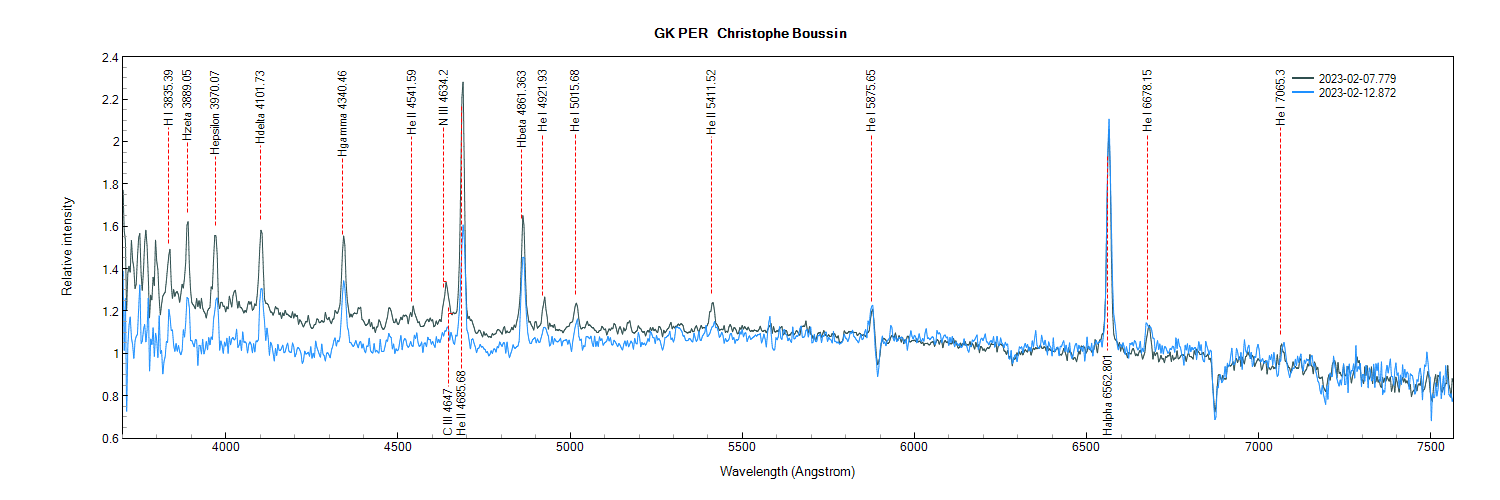

The following spectra were obtained with my Alpy 600 on 7 February at 18:41 UT (resolution of 521, JJ = 2459983.2785) with an acquisition time of 90 min (9 x 600s) and on 12 February at 20:56 UT (resolution of 531, JJ = 2459988.3722) with an acquisition time of 60 min (6 x 600s) :
GK Per on February 7th, 2023
_gkper_20230207_779_Christophe Boussin_3700_7565.png (115.09 KiB) Viewed 32537 times
GK Per on February 12th, 2023
_gkper_20230212_872_Christophe Boussin_corrected.png (114.99 KiB) Viewed 32451 times
GK Per on February 7th and 12th, 2023 (identification of some lines from PlotSpectra)
Note : the 12 February spectrum has been modified with an updated instrumental response !
