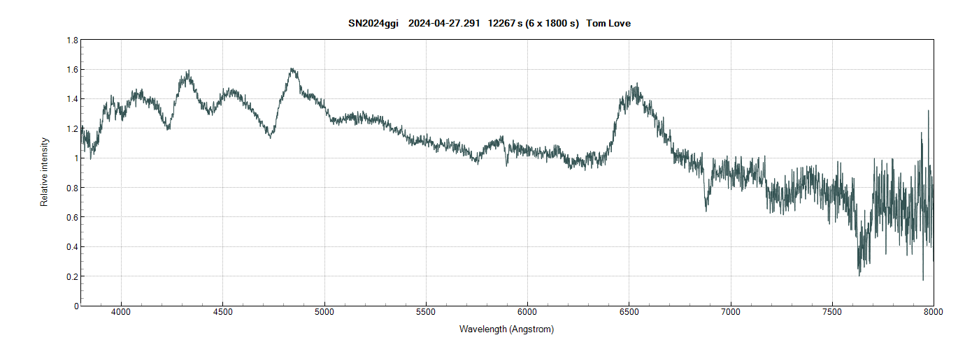

And there's much more going on now. Nice fat H lines, as you'd expect from Type II.
Re: SN 2024ggi a nearby type II supernova in NGC3621 (Dec -32 deg)
Hello Tom,
a very good follow-up to this Sn!!!

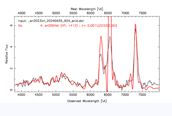

How bright did it get at maximum? I am still able to follow SN 2023ixf into the nebular phase almost a year old now with the ALPY200 currently at mag 17.5
Here is the latest fit using SNID

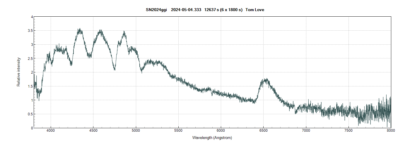

Hamish Barker, Peter Velez and I are continuing to monitor SN2024ggi - it's coming along nicely.
The filled in bit where you would expect a P Cygni style absorption to the left of the H Alpha line is interesting. I'm going to try to get a spectrum with higher S/N to see if I can bring out a little more detail in this area.
This paper is helpful on interpreting H Alpha lines in Type II spectra. https://iopscience.iop.org/article/10.1 ... 2/L15/meta

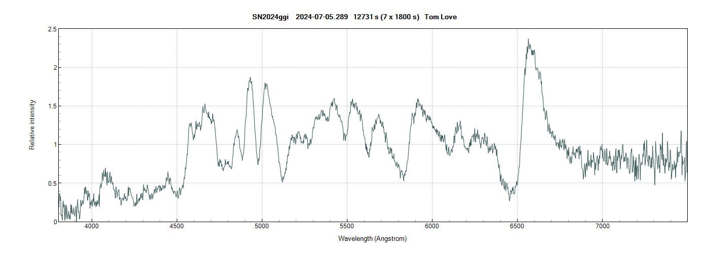

Back home after several weeks away, and SN2024ggi still seems pretty bright, though I haven't seen any recent photometry. It's getting low in the sky, though, and I suspect I won't be able to follow it much longer.
Great spectrum Tom !!!!
and a challenge to make its spectrum when it's very low on the horizon.
