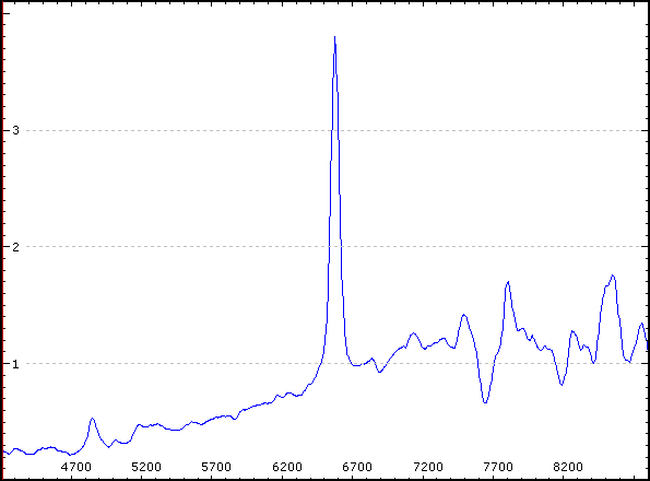

Paolo Berardi wrote:
Robin, the SA100 spectrum looks very nice, sharp with plenty of spectral features (despite the optical collimation problems). Should 2nd order contamination be a minor problem because of reddened star? The first relatively strong signal is h-beta emission that impacts at about 9600 A. I see several emissions at 7800 and 8500 A (may be there are other emissions I do not see in the background of jpg image).
Thanks Paolo,
Here is the reduced, instrument response corrected version. (Also in fits format for François)
I limited the wavelength range slightly to avoid problems with an overlapping spectrum from another star at the blue end at the red end where the second order might potentially start to become a problem as the flux increases.
For interest, I measured the EW of the H alpha line and compared it with your spectrum from the same night. I got -230 A compared with -205 A for your spectrum. A good agreement I think considering the very large difference in resolution :)

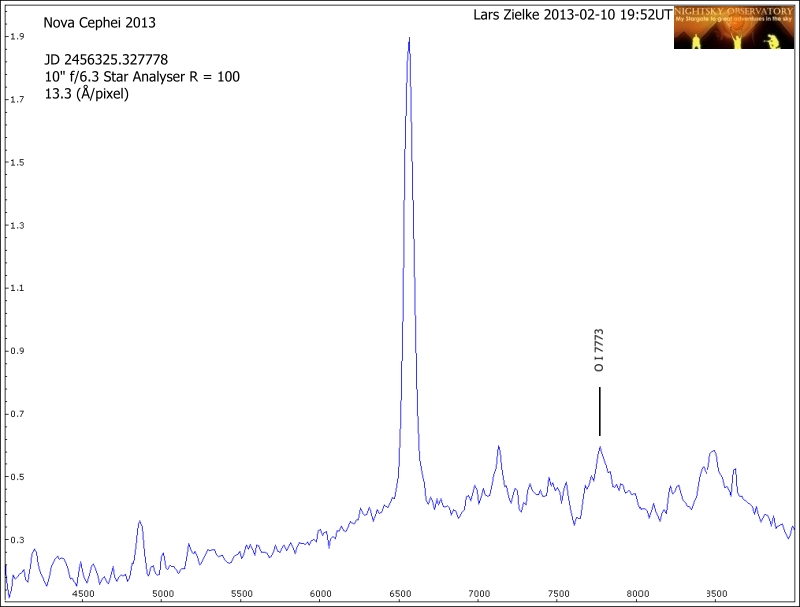

I think this is my first post here, although I've been a member for some time.
A spectrum from feb. 10th. reduced, instrument response corrected. To get better a wavelength calibration in the IR domain, I used the OI 7773Å line.
So now I need to identify the other emission lines in the IR domain.

Hello
The emission line at around 7122 Å ? Where is that emission coming from?
Lars

At 7135A usually an Argon line [Ar III] is strong in late spectra. It could be, given the fast decline of the nova. Nice result from last spectrum Francois, no more Fe emission.

Hello Ivan and Lars,
1. In spectra obtained with Lisa at R=1000, the wave lenght of the unidentified line is 7116 (far from [Ar III] 7135
2. In these *early* spectra, we have not other nebular, forbidden lines
So I doubt that the line could be [Ar III]
In the geat list of line published in Williams 2012, there's no line between HeI 7065 and [Ar III] 7135
Waiting for your comments, Ivan,
