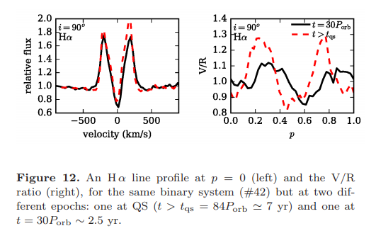

Hydrodynamical models predict that binary-induced disk oscillations produce m = 2 density waves, illustrated in this plot:
Fig. from 2018ApJ...865...76C
In this case of m = 2 density waves, there are two 'arms' of overdense regions in the disk (and, between these, regions of underdensity). As we observe this pattern to evolve over the orbital period, we should see features that are double-waved at P_orb. Or, put another way, things like the V/R ratio have a dominant signal at half the orbital period.

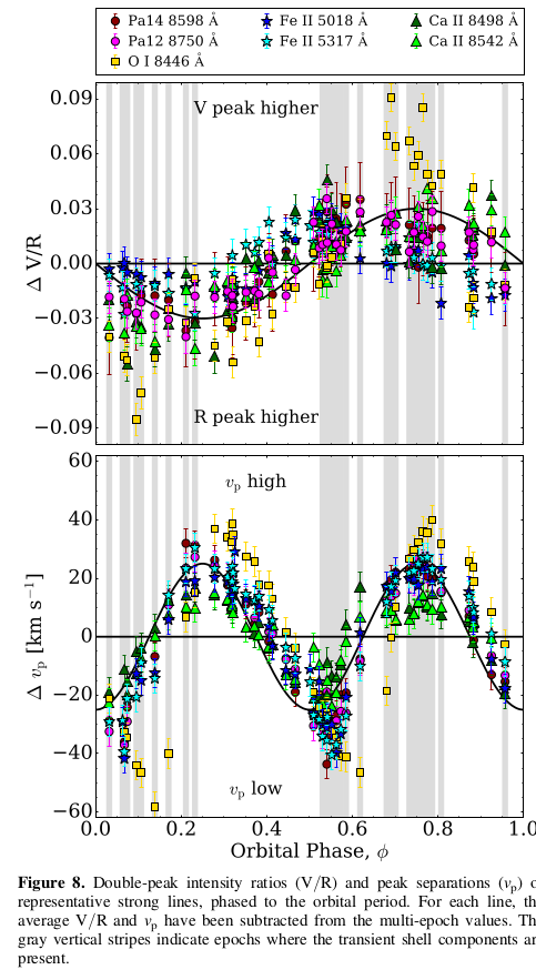

Fig. from 2018MNRAS.473.3039P
So, I believe that's what we're seeing with pi Aqr here- an m = 2 density wave with both arms of near-equal strength.

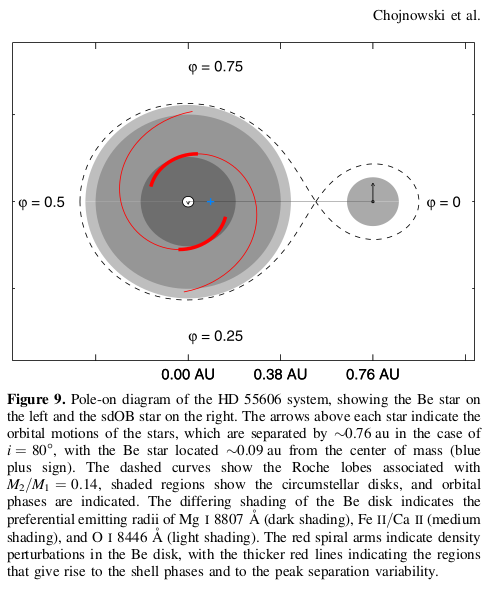

On the other hand, sometimes binary-induced density waves are still m = 2 (and two-armed), but one arm is much stronger than the other. When this happens, things like V/R have a dominant signal at the orbital period. This is what is seen, for example, in HD 55606: V/R ratios show a sinusoid at P_orb (so probably one of the two arms is much stronger).
