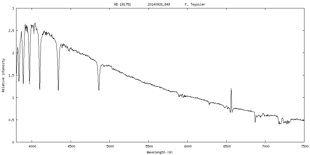

Posted: Fri Sep 26, 2014 9:26 pm
A spectrum of Andrew's Star (HD 181751)
LISA R = 1200
