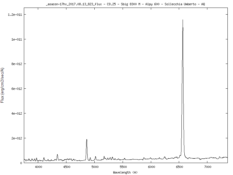

Posted: Mon Aug 14, 2017 8:45 am
by umberto sollecchia
Bonjour à tous, le profil de la nova observé le soir 13/08/2017. Umberto
Profilo nova flux.png (8.12 KiB) Viewed 10026 times

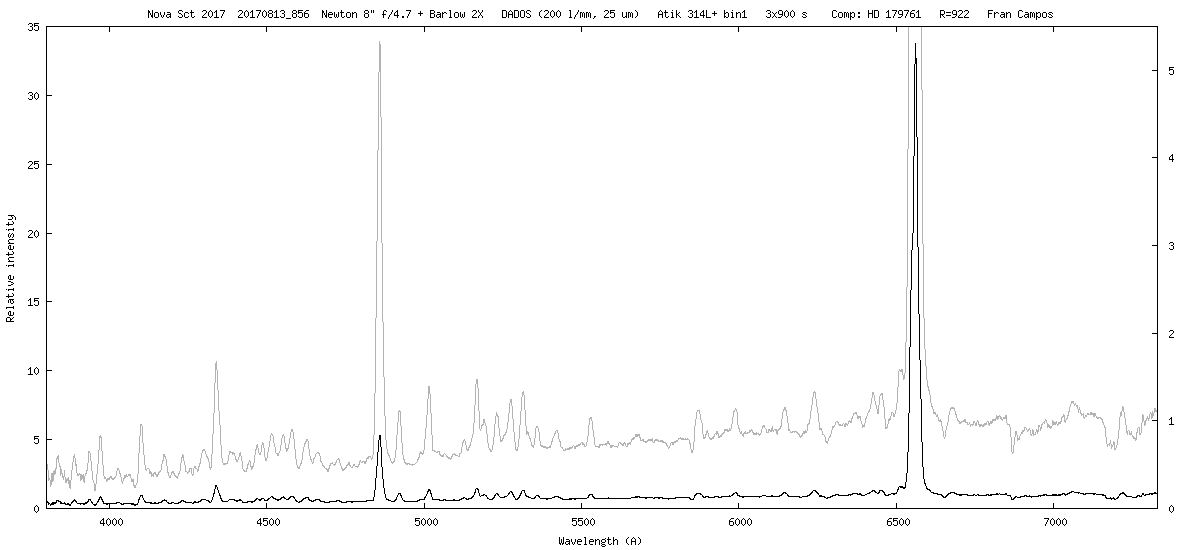

Posted: Tue Aug 15, 2017 11:09 am
by Francisco Campos
here is my contribution from the night before yesterday.
Greetings
Fran

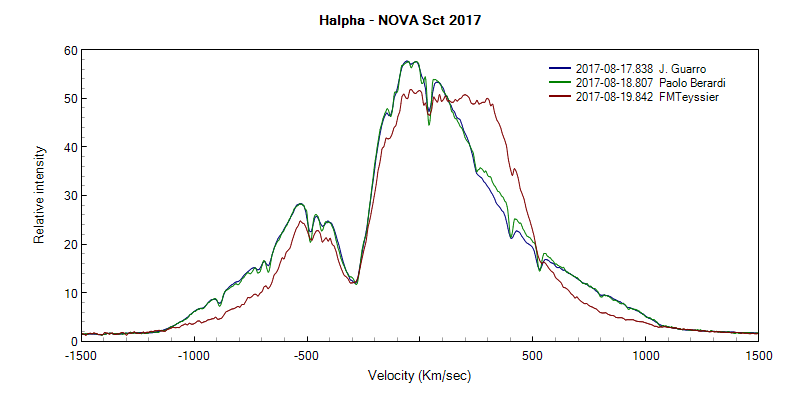

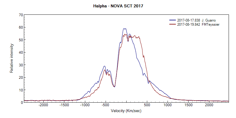

Posted: Sat Aug 19, 2017 10:08 pm
Finally, I join the campaign ...
Not easy at Latitude 50N (+ haze tonight)
But impressive change in the Balmer profiles within 2 days
Udate with Paolo spectrum (18-08)
Flat top: signature of an almost spherical ejecta - Still very opaque (absorption at -280 km/s)
