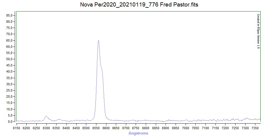

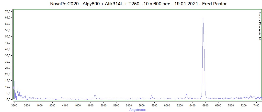

Here is my spectra taken last night, the 19th, with an Alpy 600 and a Newton 250mm. Based on 10 pic of 600 seconds each.
Nova Per2020 19 Jan 2020
Nova Per2020 19012021 Fred Pastor.jpg (56.03 KiB) Viewed 14204 times
Despite the strong intensity of the Halpha, we can't see the absorption at the top. Guess the limit of the low resolution (I obtained a resolution of 490).Or maybe I should have taken much more than 10 pictures when I see the nice spectra of Paolo, at the semae period. Below the Halpha in detail:
close up Halpha
close up Halpha
close up Halpha.jpg (47.86 KiB) Viewed 14204 times
Fred
Posted: Fri Jan 22, 2021 8:23 am
by Paolo Berardi
Nice spectrum Frederic!
I think the lack of double-peaked h-alpha line is just a matter of resolving power. See the experiment below...
The Ne-Ar lamp spectrum with Lhires III and 1200 l/mm grating
By attempts, I applied a gaussian filter to this profile so that the FWHM of lamp lines was around 13 Angstrom to simulate a R=500 spectrum (this is an approximation).
Applying the same filtering to the nova spectrum I obtained an h-alpha profile very similar to yours.
The "bump" on the right is just a bit noticeable but, given the evolution of line between Jan 16 and 18 (see my previous post), maybe the red peak was even lower on the night of your obervation.
Clear sky!
Posted: Fri Jan 22, 2021 12:03 pm
by etienne bertrand
With my Alpy600 is see a double pics in all the H-Balmer line.
Frederic i think your Alpy is not at the top of resolution. you have bin2x2 or 1x1 ? What CCD ?
You can compare with spectra in ARAS BASE : http://www.astrosurf.com/aras/Aras_Data ... er2020.htm
Posted: Fri Jan 22, 2021 4:35 pm
by Paolo Berardi
I agree, the Frederic's Alpy 600 can do more, surely. Among the causes, undersampling but it could also be due to a slight defocusing of spectrum on the focal plane.
