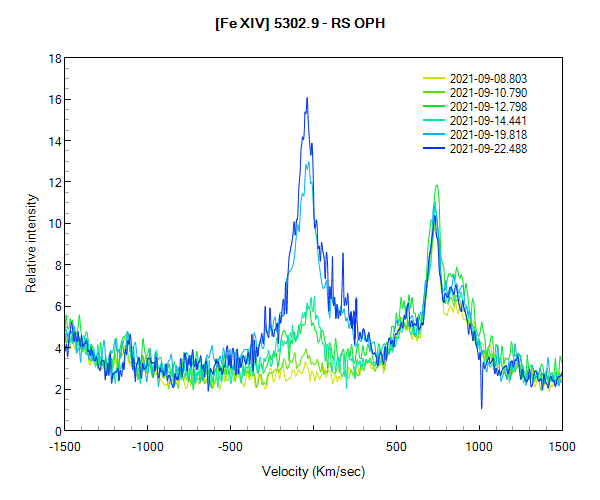

Robin Leadbeater wrote:A new line has appeared at 5303A between 20210911 and 20210919
Confirmed in a spectrum from last night by David Boyd.
https://britastro.org/specdb/data_graph ... s_id=10440
Growing rapidly and now significantly stronger than the adjacent line at 5316A

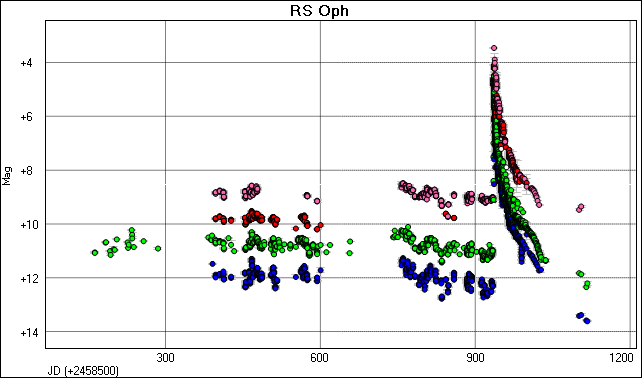

Posted: Thu Sep 23, 2021 8:22 am
Yes, Robin,
The coronal line [Fe XIV] which appeared on 2021-09-11 (+/1d) in medium resolution spectra (Joan Guarro, Colin Eldrige, Francois Teyssier)
Energy ionisation ~ 360 eV !
Updated light curve:
A list of lines id. from various publications (in .csv, plot spectra format)
http://www.astronomie-amateur.fr/Lines/ ... _SySt.html
f

To complete the discussion on RS Oph, here is a paper published in MNRAS which refers to the 2006 outburst and presents the evolution of its spectrum over about 250 days :
"Optical spectroscopy of the recurrent nova RS Ophiuchi – from the outburst of 2006 to quiescence" (Mondal 2018)
https://academic.oup.com/mnras/article/ ... 11/4768437
In particular, the evolution of the Fe lines at 5303 A [Fe XIV] (figure 15) and 6374 A [Fe X] (figure 16) are mentioned in this paper.
