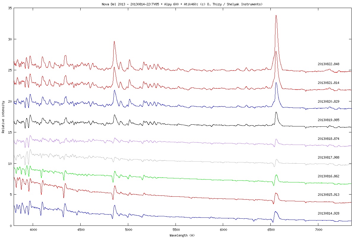

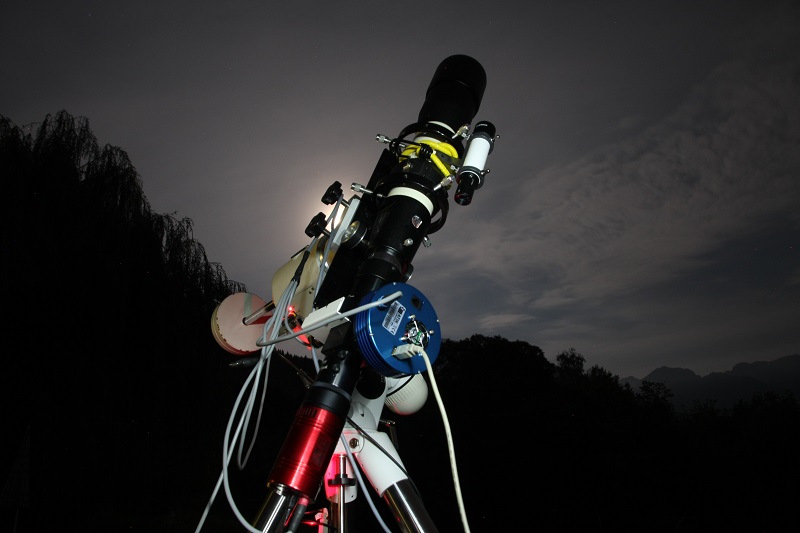

weather is turning bad but I had 30min window on the nova and I was able to get hd196544 as reference. SO I got my 9th night spectrum of the nova... :-)
Equipment is still the small Televue 85mm refractor and the Alpy 600 spectrograph with Atik Titan for guiding and Atik 460ex for acquisition. Spectroscopy is great because it can be done during full Moon and with foggy skies:
web_IMG_7190 Alpy600-TV85 moon and clouds.jpg (85.52 KiB) Viewed 28484 times
Here is the graph with one spectrum per night since the beginning on august 14th:
Halpha is actually continuing to grow drastically! :-)

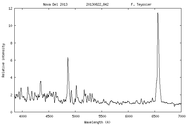

Posted: Thu Aug 22, 2013 10:57 pm
La comparaison de l'aspect de la raie Halpha entre hier et cette nuit.
Je lui trouve un air de famille de plus en plus prononcée avec
la nova Sagittari N°4 de 2012 :
http://www.astrosurf.com/buil/nova_sgr2012_4/obs.htm

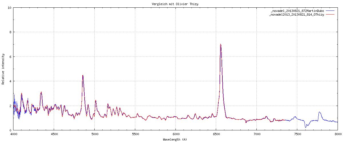

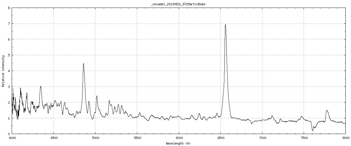

I did not want to miss this Nova. Here is my contribution to the campaign:
Special about this spectrum is, that it was recorded with my home built echelle, not as an echelle spectrum, but in the low resolution mode, bypassing the echelle grating. My echelle suffers from different drawbacks, poor grating efficiency, low camera efficiency, poor fiber transmission, small telescope (Vixen VC200), in addition hazy sky, so I had to switch to the low resolution mode (R = 650).
A comparison with a spectrum taken by Olivier Thizy from th ARAS database shows good agreement:
novaDel Thizy.jpg (61.13 KiB) Viewed 28473 times
It took me a while to figure out calibration (with A HgAr lamp) and instrument response (with a fiber flat), but it looks I managed it after a few headaches.
I hope to contribute some more spectra as soon as my LISA gets back from France.
Regards, Martin
